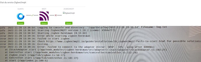

I still don’t have a connection in Z2M. I bought a new SONOFF dongle and it doesn’t work. Previously, I flashed an SD card to boot from an SSD that I re-flashed, but it doesn’t work.
I tried on the Delta box but I get different error messages.

Hello, I also have a problem with the connection between MQTT and zigbee2mqtt. I just reinstalled Gladys after trying Home Assistant, which was too complicated for me. I already had this problem with zigbee2mqtt in March during my first installation of Gladys. I solved it by manipulating the zigbee library for Raspberry users. This time, the manipulation didn’t change anything. I ran the following command « docker logs gladys-z2m-zigbee2mqtt » and I’m posting the result. Can someone tell me where the problem is coming from and how to fix it? It’s Chinese to me.
For info, Gladys on Raspberry 3B+ and SSD with Sonoff key.
Thanks in advance.

The error is « SYS - ping after 6000ms » in your photo; it’s an error that many have encountered on the forum — often it’s a power supply issue for the Zigbee dongle
I’m not sure your Raspberry Pi is capable of powering your dongle and your SSD
If it’s a Sonoff dongle, I had the issue with the « ping after 6000ms » error and I simply had to update it for it to work again.

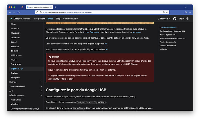

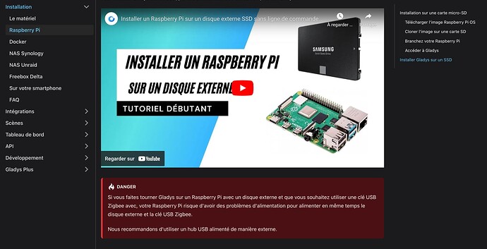

Shouldn’t that be mentioned somewhere?
Be careful: if you use a Raspberry Pi with an SSD and a Zigbee dongle, the power supply can cause problems.
I also think that would be important because this issue has occurred quite a few times!
It’s been added :slight_smile:
