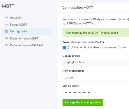

1. MQTT in Gladys
So first, we’ll enable Gladys’s internal MQTT integration:

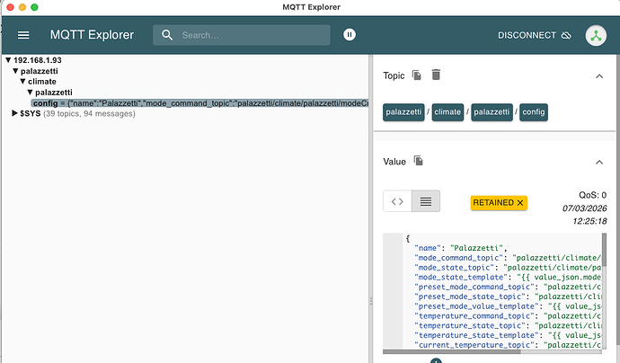

To be sure everything is working correctly at this stage, I recommend using MQTT Explorer to analyze the info coming from the stove. You create a new connection, save it, connect:
We’re good :ok_hand:
Note: I don’t have a Palazzetti stove so you might have additional info/lines.

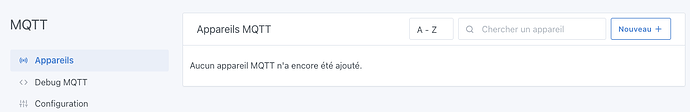

4. Creating the commands
Now we tackle the longest part: defining the different MQTT commands to control the stove.

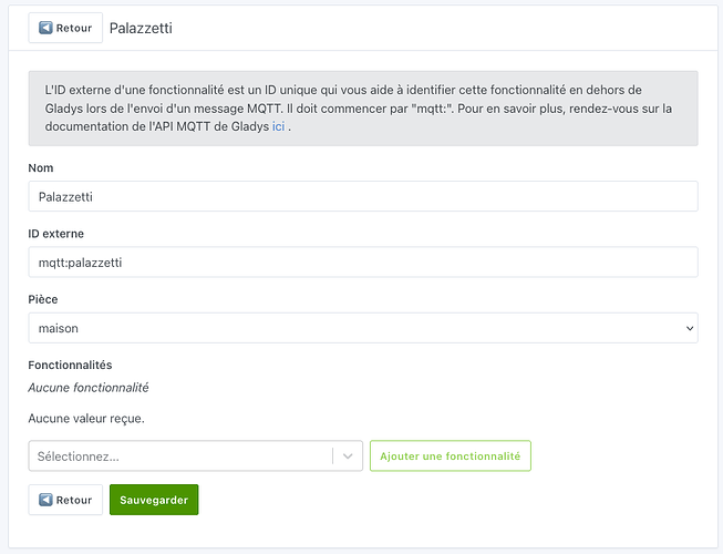

In Gladys’s MQTT integration, you create a new device that will contain all the stove’s functionalities (commands):
And you save it.

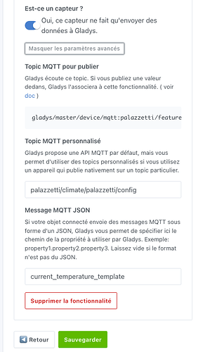

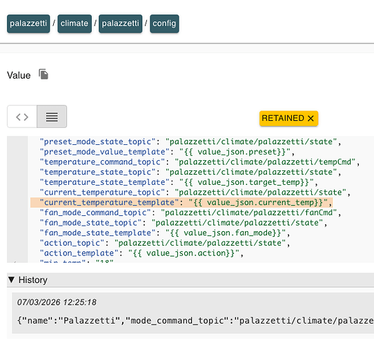

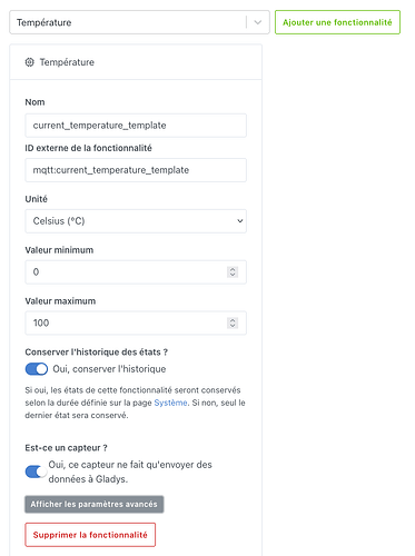

Then we create a first feature which is to retrieve the stove’s temperature and it should be this one in the information from MQTT Explorer (and from GitHub):
You choose Température from Température de l'appareil and add the feature:
We fill in the information and display the advanced settings:
And you save.

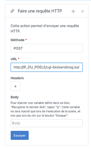

Here are all the commands you can test directly from a scene by using an action Make an HTTP request and in POST mode (if I’m not mistaken):
This will let you verify whether you can control the stove directly without going through palazetti2mqtt (it’s a test, I have an idea in mind :wink: ).

Hello, HTTP requests in the scenes work perfectly.

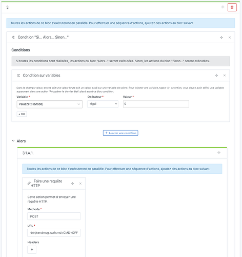

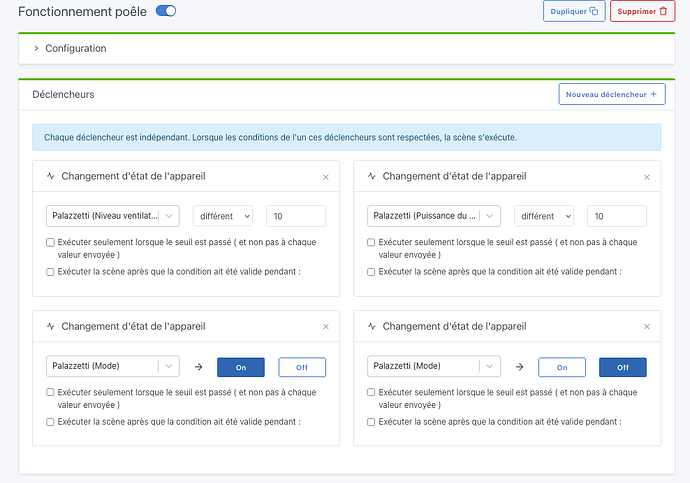

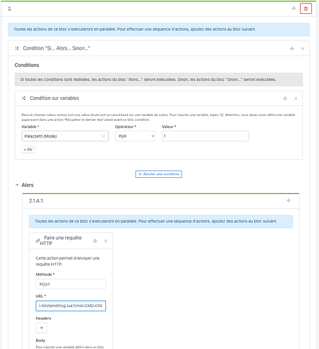

My idea is to create one or several scenes that would launch the command actions or the state reads with what I was able to find.
Perhaps even one scene for control and another scene that runs every 5 minutes to retrieve states (if you change something directly on the stove, for example).
To trigger these scenes (via actuators automatically), you’ll need to create MQTT devices (some for retrieving states, others for commands) and put them on the dashboard:
When you modify one of these actuators (fan speed for example), the command scene is triggered and will send the appropriate HTTP request.
So there’s no need to go through node-red!
If you need help with the scenes, no problem to give you a hand.

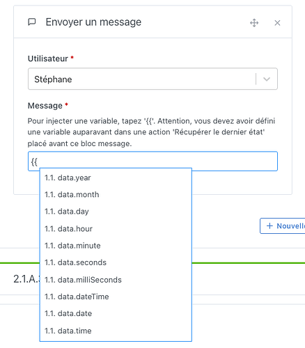

How do I then retrieve this value « 17 » to assign it to an object?

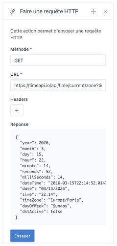

Once you have clicked on Essayer, you create a new action in a block below and you retrieve the variable with {{ , a list will appear :
To put this value into an MQTT device, you will need to get its full topic :
→ in MQTT
→ in the scene
Grrr I did try the {{ … but the list only appears after typing a space after the two braces :face_with_peeking_eye:
