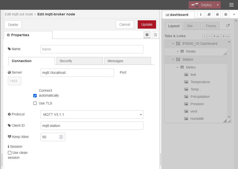

MQTT-broker node tab
about using only the alpha on the client ID and therefore not using ‹ : › causes a problem with the recommendation made by Gladys?

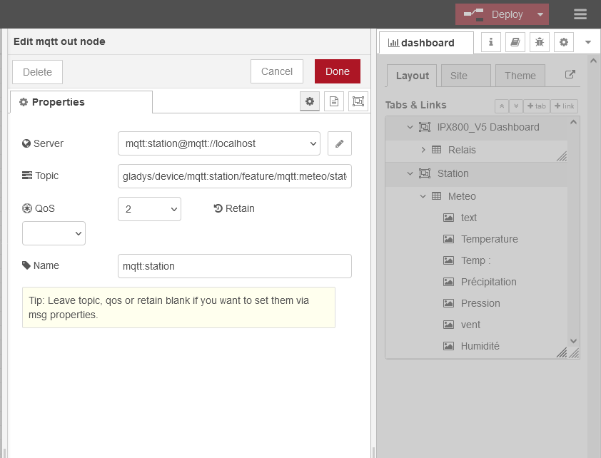

about mqtt:station@mqtt://locahost this comes from the auto-concat on the mqtt-broker tab when you parameter the server with client ID (here mqtt:station)
but between the name of the mqtt out node tab and the client ID of the mqtt-broker tab (which seems mandatory if the clean session box is not checked) this affects the display of the server name and the node name
so what do you suggest I do? I remove the two points, I don’t fill in the name, I check the clean session?

This is mainly a problem for a third-party application. For Gladys, it’s coded to accept it even if it’s not ‹ standard ›, but I think this will be modified by the developers when they have time for it!
For mqtt:station@mqtt://locahost, I’m not sure that it won’t crash on the node-red side.
Try with mqtt:localhost and alpha as indicated above and give feedback! :wink:

No, no, in the first capture, the « Client ID » is indeed configured with a name « mqtt:station » and in the second, the server name which is not conventional (after that, I didn’t look at the code level how node-red treats it :exploding_head:) and the topic which includes this « mqtt: » which is heavy but remains within the limit of a topic (256 characters max normally alphanumeric plus space and -)

Otherwise, to return to the gladys config and it’s the link I wanted to see at the node-red level, it’s the name given to « broker url » because in the node-red part @Einstein8854 puts as server name « mqtt:station@mqtt://localhost » if he created the mosquito with the same parameters it will not reference the same server so not with the correct password hence my remark!

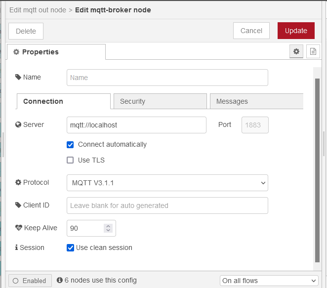

@cce66
hello,
on the mqtt out tab of nodered, i have mqtt://localhost if in the connection parameter (cf screenshot) i do not put anything in the name, and in this case i must check « use clean connection » otherwise error on deploy
