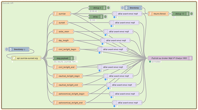

for this you must import the flow from the following message into Node-RED (it exceeds 32000 characters)
You should normally have this flow

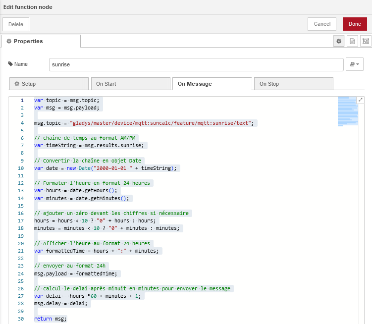

each node 'function" sends the desired value in the payload at 00:00 but also after x minutes after midnight which allows generating an MQTT message at the time of the desired event (for example the value « Sunrise » is sent here at 00:01 and at 5:42) to use it in a scene but in that case you must condition it to after 00:01

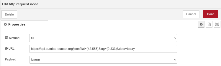

and adjust your GPS coordinates in the ‹ api.sunrise-sunset.org › node

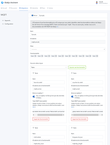

Then in Gladys, in the « MQTT » integration create a device as follows
and for each desired feature (sunrise, sunset etc) add a feature following the « sunrise » template

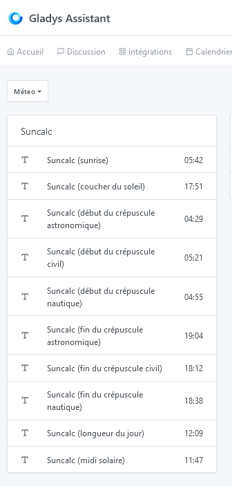

then in the dashboard add the desired values
There you go, you now have the Suncalc elements in the dashboard!

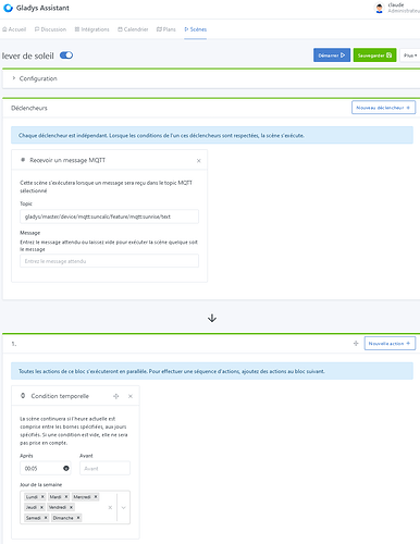

Now by creating a scene here « Sunrise » and filtering the message sent at 00:00 you can perform an action at sunrise (which already exists in Gladys) but additionally you can adjust the time in the « function » node of the « Sunrise »
mode normal
// calculate the delay after midnight in minutes to send the message
var delai = hours *60 + minutes + 1;
msg.delay = delai;
mode 20 mn before
var delai = hours *60 + minutes + 1 - 20;
msg.delay = delai;
mode 20 mn after
var delai = hours *60 + minutes + 1 + 20;
msg.delay = delai;

J’ai modifié le code car les node ‹ delay › étaient en millisecondes au lieu de minutes…oops la boulette :upside_down_face: :face_with_hand_over_mouth:! Et j’ai ajouté une focntion ‹ heure d’envoi › pour tracer l’heure à laquellle est envoyé le message « lever de soleil » pour la seconde fois (la 1ère à 00h01), il suffit de dupliquer pour tracer les autres.
Code du flow
