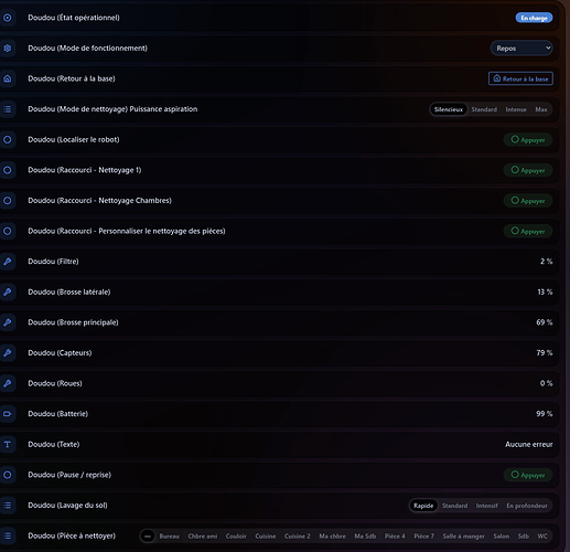

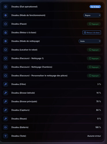

Here is my first feedback:
  • what works: « operational status Â», « return to base Â», « locate the robot Â», « Status of: filter, side brush, main brush, sensors, battery Â»,
  • what works partially:
  • « pause Â» button: when the robot is running, pressing « pause Â» does pause the robot. However, another press does not make it restart
  • Missing sections:
  • « suction power Â» I have 4 levels: quiet, standard, intense, max
  • « washing power Â»: I have 4 levels: quick, standard, intensive floor wash, deep
  • « list of rooms Â»
  • « application shortcut button Â»
I haven’t tested « the 3 shortcut buttons Â» because I don’t know what that corresponds to?
I haven’t tested « operating mode Â» because I don’t know what that corresponds to?
I haven’t tested « cleaning mode Â» because I don’t know what that corresponds to?
I’ll send you the diagnostic in the next message
