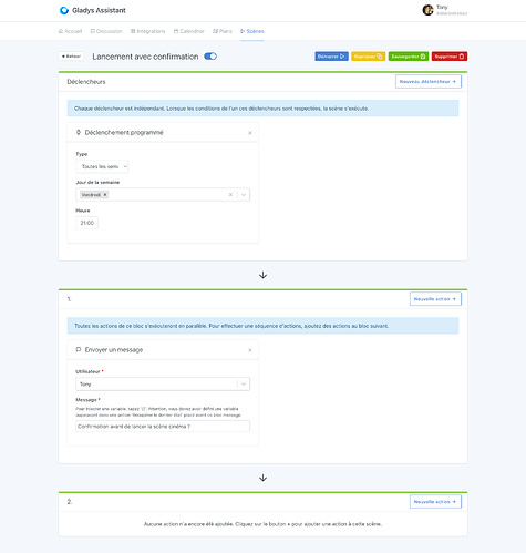

In this example, we want Gladys to ask us before launching the cinema scene.
Example with 2 scenes:
  • A « cinema » scene that launches a cinema mode
  • A scene scheduled on Friday at 9:00 PM that sends you a message « Confirmation before launching the cinema scene? »
Scene 1:
The scene that performs the final action (here I just added a message sending action as an example)
Scene 2:
On Friday at 9:00 PM, Gladys sends me a message « Confirmation to launch the cinema scene? »

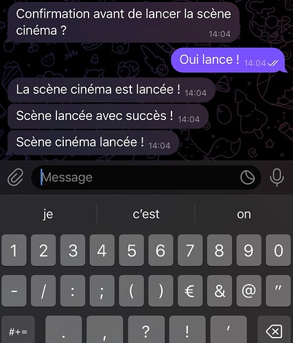

Gladys sends to my phone « Confirmation before launching the cinema scene? ».
If I reply « yes »:

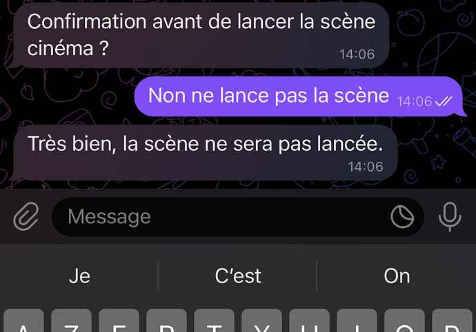

If I reply « no »:

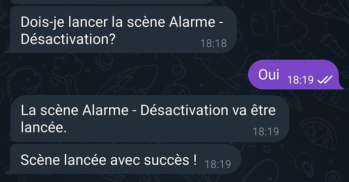

Now all that’s left is to ask Chat GPT to come up with scene ideas :sweat_smile:
I love it .. Gladys will be able to ask me to activate the alarm if the house is empty. :heart_eyes:

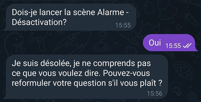

However, it’s not always functional:
Ah, maybe you could rephrase the confirmation message so that it’s very clear?
That’s the downside of AI, sometimes their behavior is not predictable :slight_smile:
