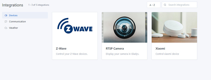

Regarding the services page, here is the Xiaomi service:
Then, when you go into the service, you have access to two pages:
  • Xiaomi Sensor: lists all sensors added to the database
  • Setup: lists all sensors found on the network and not added to the database
Here are screenshots of the two pages:
Feel free to give me feedback.
