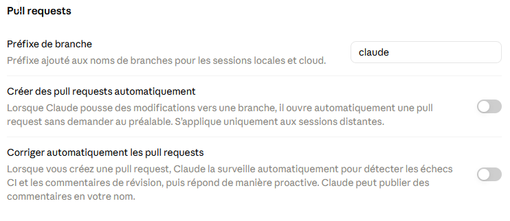

  • Be careful with the PR monitoring feature, which consumes a lot (Make sure to disable it globally and verify that Claude doesn’t enable it on each conversation)
    Globally, it’s here:
If you have any tips on your end, don’t hesitate to share them—I’ll add them here :wink:
