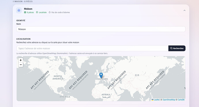

I don’t know if it’s me who’s missing a new configuration to set up, but the maps are no longer displaying:
Did I miss a configuration info to change?
Thanks

I saw it on the demo site but didn’t notice it on my production instance.
Hi @Sescandell , thanks for the feedback, it doesn’t have much to do with the v5 release, it just happened to coincide, CartoDB no longer allows using its maps without an API key
We’re just going to change maps then:

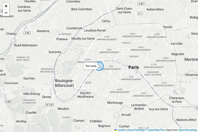

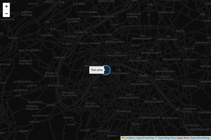

CARTO now watermarks its free raster basemaps with **"API KEY R… EQUIRED"**, which breaks every map in Gladys (maps view, area creation/edit, house location in settings, and the signup house step).
This PR switches the basemap to **[OpenFreeMap](https://openfreemap.org)**, which hosts the exact same open styles CARTO used to serve (Positron for light mode, Dark Matter for dark mode) with:
- **no API key and no registration** — well suited to a fleet of self-hosted instances,
- **public self-hosting instructions** for the full tile stack, should we ever want to host the tiles ourselves,
- the same clean light/dark design as before.
How it works:
- OpenFreeMap serves **vector tiles**, rendered by MapLibre GL **inside the existing Leaflet maps** via the official `@maplibre/maplibre-gl-leaflet` plugin — all markers, circles, tooltips and click handlers are untouched, and `.leaflet-container` (used by Cypress) is unchanged.
- The tile-layer setup is factored into a shared `front/src/utils/mapTileLayer.js` used by the 4 previous CARTO call sites.
- `maplibre-gl` is **loaded on demand** (dynamic import), so the main bundle keeps its previous size (4,870 kB before/after); MapLibre lives in a separate 252 kB gzip chunk fetched only when a map is displayed.
- If WebGL is unavailable, the map falls back to raster OpenStreetMap tiles.
Rendering verified headlessly with the new basemap, light mode:
| Light (positron) | Dark (dark) |
| Positron light style, identical to CARTO `light_all` | Dark Matter style, identical to CARTO `dark_all` |

The rendering remains very similar:
It’s merged and it will go to production today
