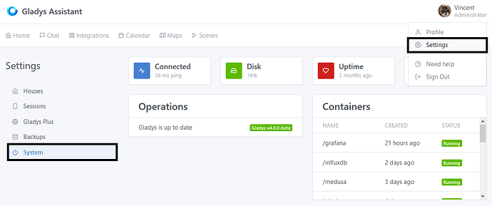

To check if you’re up to date, it’s as simple as this: « Gladys is up to date Â»
Not yet, it will only work when Gladys is versioned (when we are out of beta)! For now, it only displays « Gladys is up to date Â».

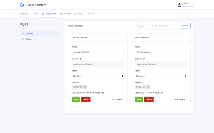

Among the new features, the ability to see when the last value was received on each device:

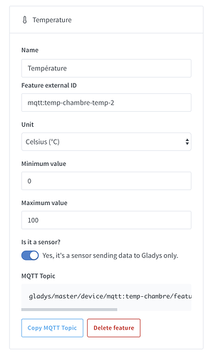

A small UX detail but which is so practical, the ability to copy and paste with one click the MQTT topic on which the device listens/publishes:

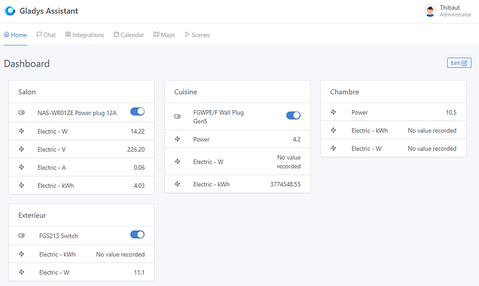

I’ve looked into the neo coolcam and here’s the result, I think it should meet your needs:

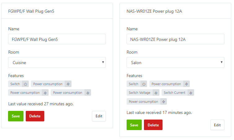

@pierre-gilles, I noticed that two comClass are used to report Watts
 Moreover, some interesting class indexes were not mapped. I added them and now we have more information. Namely: Watt / Volt / A / KWh.
However, it is clear that there are two features reporting the same information: « Power Consumption Â» so Watts. It’s not great, because I have the impression that some information is not reported: « No value recorded Â». I will let it run tonight to see. Otherwise, it would be necessary to filter by productCode in order to eliminate the comClass not used for certain products.
I take this opportunity to report a few bugs:
  • The On/Off button does not appear on my Fibaro dimmer 212 as shown in the first capture (Bedroom). → Probably because it’s a dimmer switch and not a classic On/Off.
  • The On/Off of the fibaro FGS213 (Outside) no longer works. I say no longer works because I am convinced it worked in an old version. I do have an http return: 200 but nothing happens.
  • Sometimes the On/Off toggle of the Wall Plug or the neo coolcam no longer wants to work, I have to change tabs for it to work again.
  • The fibaro Roller Shutter is not usable as is. I will check if it comes from openZwave or Gladys.

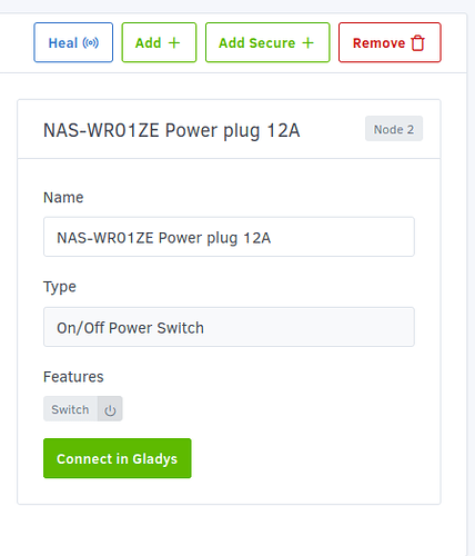

On my end, for some reason I don’t know, my Neo Coolcam plug is detected with only the switch function
 :frowning:
This is the current behavior. I have modified the zwave service to get the other information. It is therefore only on my dev instance for the moment.
