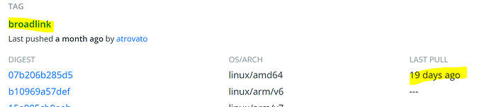

I was just monitoring the downloads on Docker, your image doesn’t seem to be the latest one I built because
You need to remove the image (rmi atrovato/gladys) so you can re-download it :smiley:
So the first test tonight was just pulling the existing image (so an update) which had the error code shown above.
The new one is after testing deletion and then uploading a new image and it’s still the same issue.

You need to pull, destroy the container and recreate it. Is that what you did?
