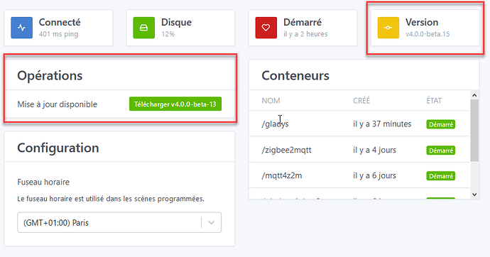

@pierre-gilles, I think I have a small issue, and Iâm not sure if Iâm the only one. I added the latest Docker image from the documentation, everything is fine but if I go to settings/system I see:

Yes, there is a problem with the image pulled by Docker, it is not the latest one
https://github.com/GladysAssistant/Gladys/issues/635#issuecomment-687579964
I have not yet identified the cause (docker cli / dockerhub / manifest)
Actually, itâs a silly problem, I think in terms of semver « v4.0.0-beta-13 » is greater than « v4.0.0-beta.15 » ^^. Normally everything should be back in order, I added « v4.0.0-beta.15 » as the latest version in the update API.
Iâm starting to wonder about the relevance of the « download » button when watchtower does everything automatically anyway.
I agree with you on that (useless)
Yes you are right, I thought it was related to the builds and the PR recently merged
