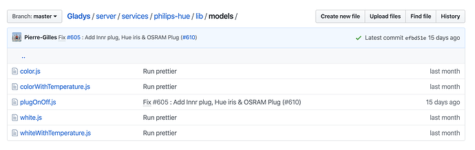

Well, itâs simple, if you look there are 5 types of models managed for now, in the « models » folder of the service:
color â when itâs a bulb/lamp that manages color, but not temperature (you can see this in the JSON if there is temperature management)
colorWithTemperature â when itâs a bulb/lamp that manages color + temperature (there is an attribute "ct":153 for example in the first lamp of @Tlse-vins , itâs therefore a bulb that manages temperature)
plugOnOff â itâs an on/off plug.
white â itâs a bulb without temperature and without color
whiteWithTemperature â itâs a bulb without color but with temperature. The attribute « ct » is usually present in the json!
I donât have an exact methodology, itâs mostly with a quick look at the JSON that I see what features the lamp has, and therefore what type of model it belongs to
If it manages another type of features, you need to create a new model of course
