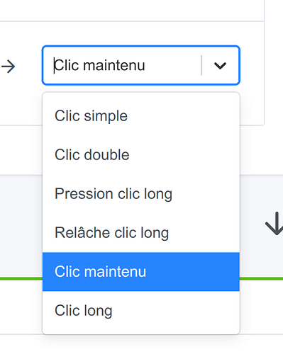

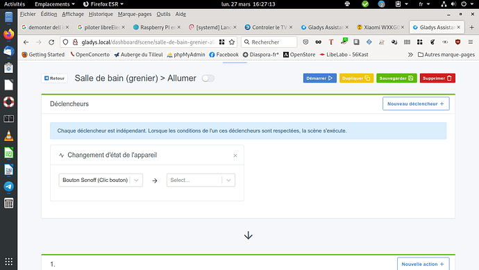

I have no idea how this new, more user-friendly command system works, but when I try to create a scene that uses my Zigbee Aqara WXKG11LM button, I end up with these options:
It’s not very clear, to be honest, because there are some somewhat redundant things. Especially since on the z2m side the possible commands are:
single, double, triple, quadruple, hold, release
Does this require a specific integration for each device?

For my part my scenes were working but I noticed while editing those with a button that it was necessary to re-save « Single click »
On the other hand it took 2 days to install (after seeing that I had moved to V4.18), but I didn’t need to tweak the scenes, all my scenes with that button work
I think that as it stands there is only one type of selector, regardless of the device, even if it doesn’t necessarily handle every type of click.
And why not simply report the same information as z2m? I feel like we’re complicating things for no reason. That would avoid having to recode all the button types, right?
That said, it’s easy to say but maybe not necessarily easy to set up with the current logic.
