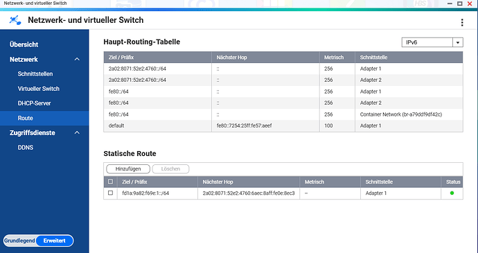

QNAP does not use IPv6 at the moment. It must be activated manually. But then there is a crucial step to perform. You must configure a static IPv6 route to the Matter Hub on the virtual switch that manages the Gladys containers:
… and that’s it
