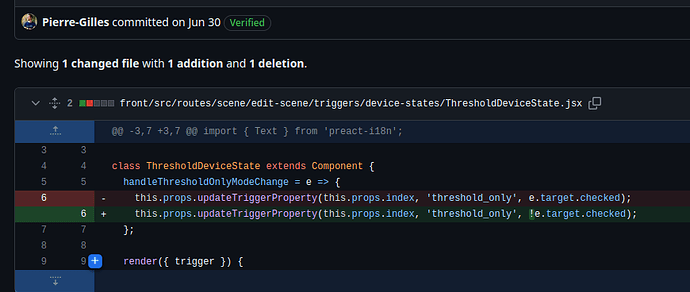

Same bug, but if it’s already checked then you can’t uncheck it anymore
That’s the same.
A regression (the bug had already been fixed, it seems to me)

I tried, and by removing what you fixed in June it works again for me

So the issue and the PR

Thanks for the PR! Indeed it fixes the problem, but in my opinion the root cause is deeper than that — I wouldn’t be surprised if we see the issue resurface in the future.
I think the problem comes from a Preact bug; I found this GitHub issue while searching a bit:
https
It’s clear that it’s not normal to have to modify it like that. Worth keeping an eye on.
