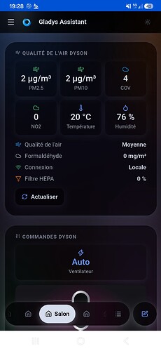

Great, it’s good
You did the right thing by making it small and not in a tile, I’ve never seen that thing move :joy:
Thanks
@Nagromdark you’ll need to change your HEPA filter :wink:
Yeah but every time I see the price I put it off.. :joy:
