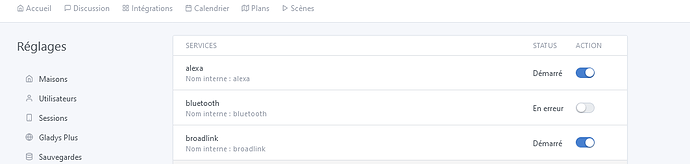

I successfully retrieved the Gladys Assistant v4.13.1 version and the Ecowatt display, but at the same time my Bluetooth is no longer enabled
and I can’t restore it by clicking on the Bluetooth action button. I’m saying this because it corresponds to the Gladys update. Could this come from Node.js 18 LTS? I had just installed it when switching to a 32-bit version :smiling_face_with_tear:
Indeed,
I hadn’t noticed but since the 4.13 update Bluetooth is no longer active and when I look in the services it shows an error!
We need some information to understand what’s going on and resolve the problem.
docker logs gladys
In general, hardware issues are at the beginning of the log

Excerpt from my Gladys log:
2022-12-09T19:35:39+0100 \u003cinfo\u003e index.js:15 (Object.start) Starting Bluetooth service
2022-12-09T19:35:39+0100 \u003cwarn\u003e service.start.js:44 (Service.start) Unable to start service bluetooth Error: Cannot find module '@abandonware/bluetooth-hci-socket'
Require stack:
- /src/server/services/bluetooth/node_modules/@abandonware/noble/lib/hci-socket/hci.js
- /src/server/services/bluetooth/node_modules/@abandonware/noble/lib/hci-socket/bindings.js
- /src/server/services/bluetooth/node_modules/@abandonware/noble/lib/resolve-bindings.js
- /src/server/services/bluetooth/node_modules/@abandonware/noble/index.js
- /src/server/services/bluetooth/lib/commands/bluetooth.start.js
- /src/server/services/bluetooth/lib/index.js
- /src/server/services/bluetooth/index.js
- /src/server/services/index.js
- /src/server/lib/index.js
- /src/server/index.js

Ok, there’s a dependency problem ( the library that handles Bluetooth isn’t installed)
We’ll fix that.
