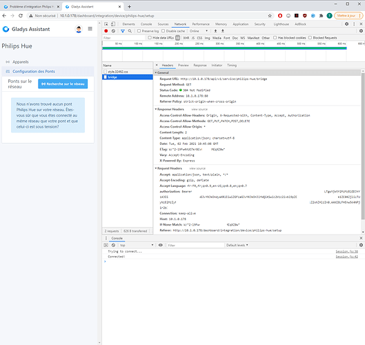

I installed gladys from the image on a raspberry 3, no problem. I configured the weather, a raspicam camera, mqtt and Telegram.

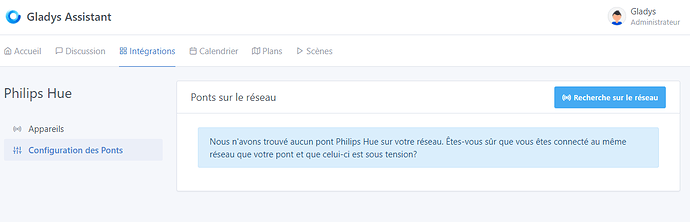

However, when I try to integrate a Philips Hue bridge, no luck…
The bridge and connected bulbs work well with the android app and with Google Home, but Gladys does not detect the bridge during the search. Whereas when I type the IP of the bridge in a browser, I can access the bridge’s home page.
I don’t know where to look to solve the problem, thank you for your help.

I have made X attempts… button pressed or not, refresh, reboot, etc… nothing to do…
The Philips hue service seems to be started. I tested by connecting to « Gladys.local » or @IP and nothing to do.
The software version of Gladys is ok v4.0.4 and the bridge as well.

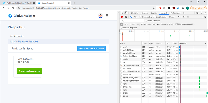

  2021-02-02T12:01:56+0100 <info> light.getBridges.js:10 (PhilipsHueLightHandler.getBridges) PhilipsHueService: Found 1 bridges
I stopped/started all services several times. Spamming the « Search on the network » button, going back and forth on the page. And waited about 30 minutes… I don’t know what triggered the discovery.

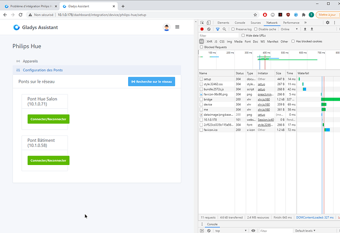

For my part, I have 2 points, the second one was just seen, almost 1 hour later:
Good, I just tested on a clean installation with V4.0.4 and the bridge was seen instantly.
As well as the devices.
No problem on my side.
Same thing, instant detection
