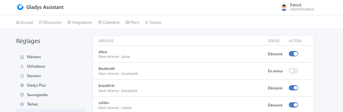

It’s working now, thanks. As soon as I’ve tested it I’ll
I tested it on my Gladys Plus account, but I still have the bluetooth error:
Here are the logs:

I have all containers started except Node Red which is rebooting, I will stop it
pi@gladys:~ $ docker ps
CONTAINER ID   IMAGE                       COMMAND                  CREATED          STATUS                                    PORTS      NAMES

Uh, hang on,
I saw your message afterwards; I launched it directly on my instance via PuTTY and then restarted the Pi — I think I was too quick. I hope it’s not destructive, but if everything needs to be reinstalled, no problem; I’m getting pretty good at it.
@Psoy @gaetanb76 I separated this discussion into another thread so as not to bother everyone :slight_smile:
@Psoy can you be more specific, what do you mean by « I launched directly on my instance via PuTTY then I restarted the Pi »? Describe step by step what you did :slight_smile:
On PuTTY I ran Vonox’s command, everything deployed correctly
I ran docker ps, I saw that the containers were starting, PuTTY returned control to me
so I rebooted the RPI.
On restart, all the containers were installed and I opened Gladys as usual,
Gladys opened, with all my devices, dashboard as usual
From there I copied the logs and screenshots for you
I did not perform a Gladys restore
Aaah ok!
You’re looking at the wrong container in my opinion.
Reread the command you ran, Gladys « de test » must be running on port 8001
( cf: -e SERVER_PORT=8001 \ )
And the container is called gladys-test-bluetooth so to see the logs it’s:
docker logs gladys-test-bluetooth
Is there any confidential information in the logs? I’m asking because, since I’m not familiar with it, I’m going to copy everything.
Normally not! At worst I’ll tell you and you’ll remove it
Is the Bluetooth already working?
So I created a local account.
The Bluetooth service is running properly.
It can see devices.
My Nut isn’t detected… Oh well.
here are the logs

I think Gladys doesn’t see these containers, because I still have this error in the service
Perfect! So that really solves the issue :slight_smile:
I don’t see any errors in the logs you provided, and the Bluetooth service seems to be working!
@pierre-gilles I think the most important message was here ^^’
Indeed, in the logs I saw that Bluetooth had started correctly. What I mean is that my
I think you didn’t understand.
You installed, via vonox’s command, an instance of Gladys that is trying to fix Bluetooth.
You didn’t install a Bluetooth-only container…
At first, we’ll need to wait for feedback to check that the container actually fixes the issue, then your main Gladys instance will receive the correction afterwards.
Which instance are you talking about, the test one you just installed or the « Official » one you use every day?
The two are not linked…
