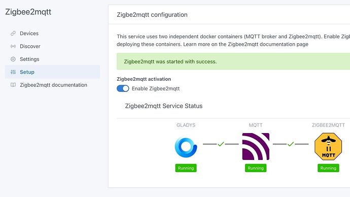

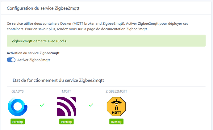

So, I added a view to monitor the service’s operating status at the time of its activation:
I also left the table with the container status, just in case, to troubleshoot a user if necessary, but I think I will remove it in the version that will be integrated to Gladys.
