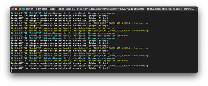

For information, I tested the PR this morning, and I still have the same issue. The discover feature is a bit of a mess:
I’m not doing anything crazy, I’m just browsing the UI. Are you able to reproduce this kind of error?
Indeed, on my end, the same problem occurs, although it might also be because I’m using WSL2 for testing
I’m not sure how WSL2 works. Is it due to network isolation, meaning the search is performed on the local network (of WSL2) and not on the WIFI / WAN network?
