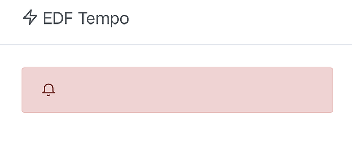

I just noticed that the EDF Tempo integration seems to be down:
Is this an issue on EDF’s side?
