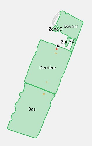

Why only one zone
  • Gladys asks the robot for the list of zones (buildZoneListRequestContent, the « zone name list »), then starts mowing on all received zones.
  • Most likely hypothesis: this list only contains zones that have a name. Zones without a name are ignored. I haven’t checked this yet.
  • Another possibility: the robot sends the list in multiple messages and Gladys only keeps the first one.
  • To decide, look in the Gladys logs for the line:
    planning a route over N zone(s) (…)
    It indicates how many zones were found, and which ones.
What I propose to fix
  1. Retrieve the real list of all zones (the list of « map hashes », not just those that have a name).
  2. Make the settings modifiable in the service config: height, spacing, speed, border tours, zones to mow.
Do you want me to make these changes? If so, send me the log line above and your usual settings in the app.

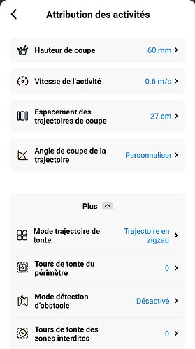

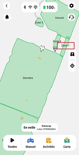

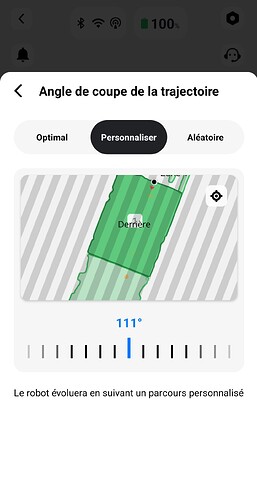

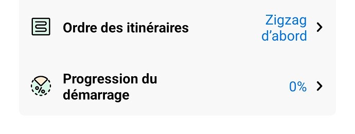

  • I have 6 zones on my map
  • for MY default values, set
Cutting height: 60 mm
Speed: 0.6 m/s
32 cm between passes
Cutting angle: 111°
Mowing trajectory mode: zigzag trajectory
Perimeter mowing lap: 0
Obstacle detection mode: disabled
Mowing lap for restricted areas: 0
Order of routes: Zigzag first
Start progression: 0%
I pushed corrections based on your feedback in 1.0.9
The cause
  • To know the zones, Gladys asked the robot for its list of zones. However, this list only contains zones that have a name in the Mammotion app. In my case, only « Derrière » had one, out of 6 zones.
  • The mowing settings were hardcoded in the code. These are the default values of Home Assistant: 1 perimeter pass, 25 cm, 0.3 m/s, obstacle detection enabled.
  • The Mammotion app keeps its settings in the phone: Gladys cannot read them.
What has changed
  • Gladys now reads all elements of the map and keeps the zones, with or without a name (same method as the PyMammotion library used by Home Assistant).
  • The type of each map element is only requested once, to avoid overloading the Mammotion cloud.
  • If the robot does not respond, Gladys reverts to the old behavior (only named zones).

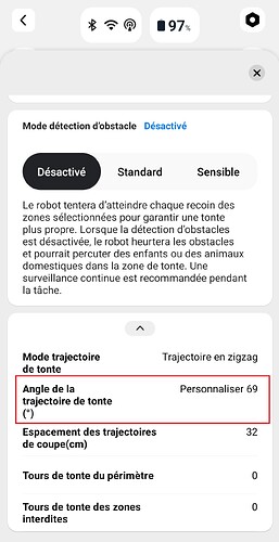

Points to confirm on a real robot
  • The angle is sent in « relative » mode. To be verified against « Customize » in the app.
  • « Disabled » for obstacle detection corresponds to the value 0 (direct contact). To be confirmed.
  • A zone without a name is called « zone 1 », « zone 2 »… in the logs. To select it in « Zones to mow », it is better to give it a name in the app.

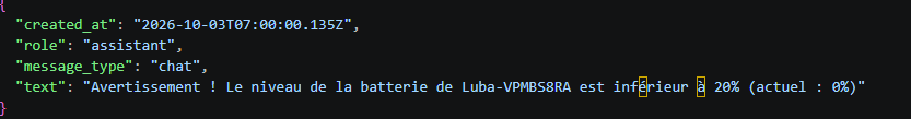

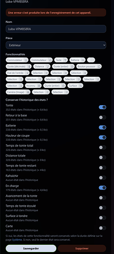

for once, it’s not a test of the latest version, but a message I received from gladys:
Screenshot 2026-10-03 095545
2 issues: where does this message come from? and on top of that, it’s false
Screenshot 2026-10-03 095406
Here is the JSON of the message:
Here’s what I think: an external integration can trigger the system warning from gladys
So gladys should retrieve the correct value! (or not handle this issue with external integrations?)
@prohand @pierre-gilles
Thanks

  • « Charging » leaves the battery category:
    • before: battery / charging
    • now: input / binary, the standard yes/no measurement of Gladys
    • same 0/1 value, and it still works in scenes
  • New identifier charging-state (instead of charging): the old measurement is no longer fed.
  • In addition: a battery at 0% coming from the cloud is ignored. Protobuf reports already did this. A 0% of this type would trigger the same false alert.
  • Doc: README, docs/fr.md and docs/en.md updated, with an entry in troubleshooting.
  • Tests: a test checks that only the battery in % remains in the battery category.

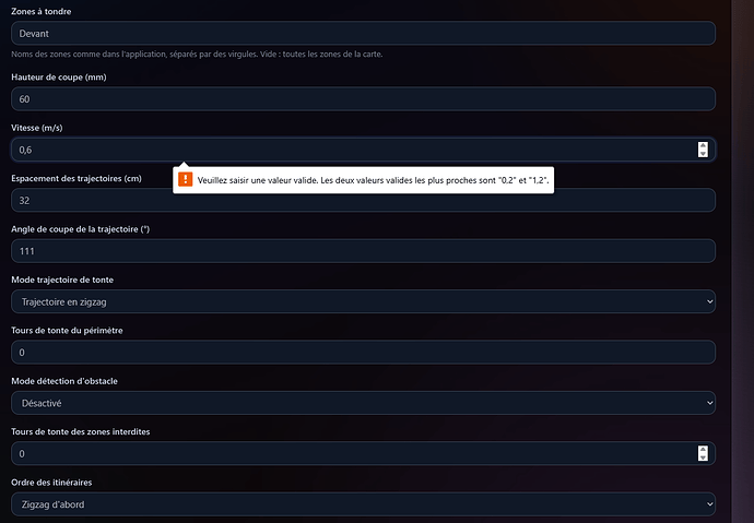

I have a problem saving the configuration:
the movement speed selection only accepts 2 values: 0.2 and 1.2
therefore the default value (0.6) is not accepted
So the « mow » button always starts mowing by default with the mammotion app settings

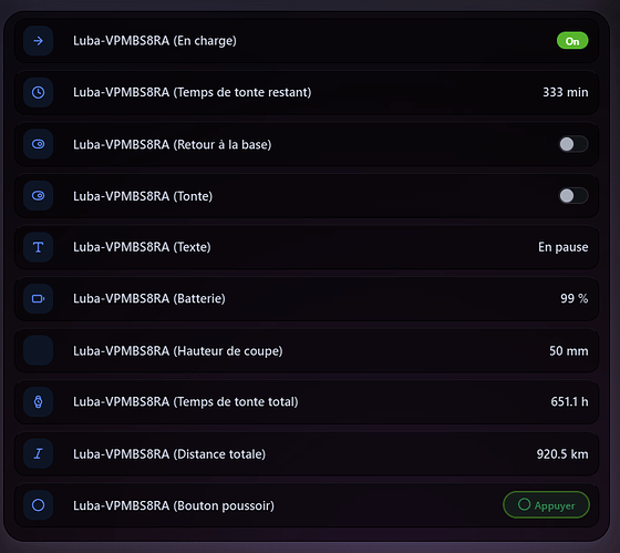

Last question: it would be to be able to control the robot as the external integration « dreame » does, that is, to be able to make all the settings in devices (and not at the configuration level) and then start a mow with these settings

1. The configuration was not saved (speed)
  • The speed field only accepted 0.2 and 1.2: the Gladys form advances in steps of 1 from the minimum.
  • As a result, nothing was saved (zones, height…). The mowing started with the default values.
  • The speed is now a list from 0.2 to 1.2 m/s.

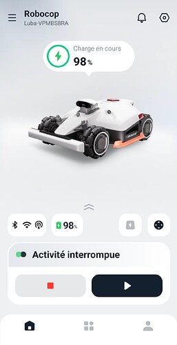

2. « Return to base » left the mowing on pause
  • When mowing is paused, Gladys first sends Stop, then Return to base, as in the app.
  • No need to do Stop in the Mammotion app.
  • During ongoing mowing (not paused), nothing changes: simple return, mowing can resume afterwards.

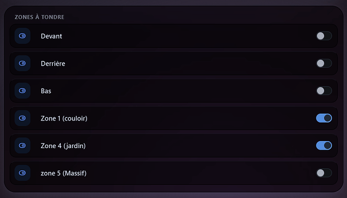

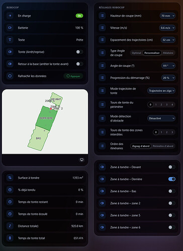

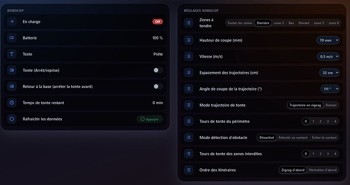

3. New: settings on the device (like Dreame)
  • The mower now has « Setting – … » lists: zones, cutting height, speed, spacing, angle, trajectory mode, perimeter laps, obstacle detection, forbidden zone laps, order.
  • You choose the values (dashboard or scene), then turn on Mowing: the mowing starts with these settings.
  • At startup, the lists take the values from the configuration.
  • A choice on the device applies only to that mower.
  • A new value saved in the configuration applies to all mowers.

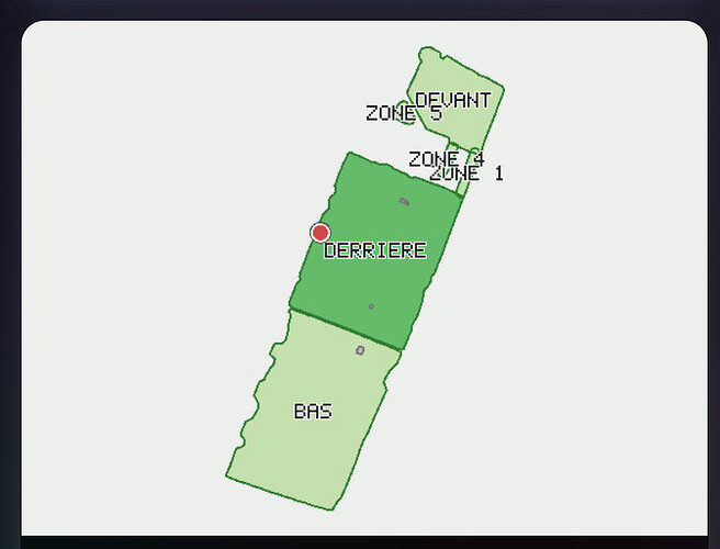

  • The zone list offers « All zones » then each zone on the map. The map is read at the start of the integration and at each mowing.
  • Scene example: on Saturday, « Zones to mow » = « Front » then Mowing; on Wednesday, « All zones ».

For you to test, Chris75
  • Pause then Return to base: does the mower return properly and is the app no longer in pause?
  • If the zone list only shows « All zones », the mower hasn’t sent its map yet: restart the integration with the mower turned on.

Test and dashboard in V1.0.11
Changes to make: adapted to the Luba 2 robot
  • cutting height adjustment: from 25 mm to 70 mm in 5 mm increments
  • activity speed adjustment: from 0.2 m/s to 0.8 m/s in 0.1 m/s increments
  • trajectory spacing adjustment: from 20 cm to 32 cm in 1 cm increments
  • trajectory cutting angle adjustment: there are 2 settings
    – choice between « optimal », « customize », « random »
    – then if you choose « customize » there is an angle setting: from 0° to 180° in 1° increments (important to have nice parallel/perpendicular lines to the house)
  • mowing trajectory mode setting: missing the « adaptive zigzag » option
  • mowing rounds setting for no-mow zones: from 0 to 3 in increments of 1
  • missing the « startup progression » setting: from 0 to 99% in 1% increments (this setting allows mowing to start at x% of the zone)
  • create devices to display the percentage of the mowed area, remaining time, elapsed time, and the area to be mowed
  • missing the ability to select multiple zones to mow (same issue as for the external Dreame integration)
  • and if possible create a « map » widget that displays the zones and the robot’s positioning (see also what is done in the external Dreame integration)

Everything you asked for is in 1.1.0, including the map.
  1. Lists follow the mower model
    Gladys reads the model from the mower’s name (Luba-VP… for you).
    On your Luba 2 X:
    cutting height: 25 to 70 mm in 5 mm increments
    speed: 0.2 to 0.8 m/s in 0.1 increments
    spacing: 20 to 32 cm in 1 cm increments
    No-mow zones: 0 to 3.
  2. Cutting angle
    New Angle Type list: Optimal, Custom, Random.
    Then Custom Angle: 0 to 180° in 1° increments.
  3. New settings
    Adaptive zigzag added in the trajectory mode.
    Start progression: 0 to 99 % in 1 % increments.
  4. Multiple mowing zones
    A « Mowing Zone – … » switch per map zone (it replaces the old « Mowing Zones » list).
    You turn on the desired zones, then Mow.
    If no zone is turned on, the mower mows all zones.

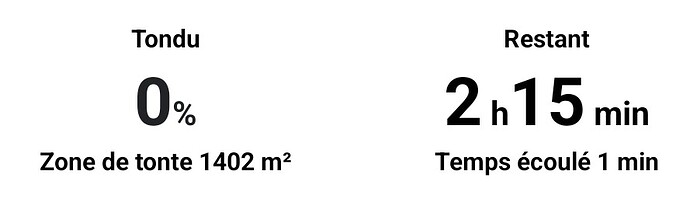

  5. New values during mowing
    Mowing progress (%)
    Mowing time elapsed (min), in addition to the remaining time
    Area to mow (m²)
  6. The map
    The mower now has a Map: an image with the zones and their name, the no-mow zones in gray and the mower as a red dot.
    Bright green: the zones of the next mow. Pale green: the others.
    The image follows the mower during mowing.
    To display it: on the dashboard, add a Camera widget and choose the mower.

The map: is it in the right direction compared to the app, or rotated or inverted? Is the red dot in the right place? A screenshot would help.

[2026-10-04T17:03:24.418Z] [INFO] Luba-VPMBS8RA: blade_height = 60 for the next job
[2026-10-04T17:03:34.830Z] [INFO] onSetValue <- ext:ext-prohand-gladys-mammotion:mower:nNlJJBp0Cxx538To70i6000000:setting-mowing-speed = 0.6
[2026-10-04T17:03:34.830Z] [INFO] Luba-VPMBS8RA: mowing_speed = 0.6 for the next job
[2026-10-04T17:03:40.082Z] [INFO] onSetValue <- ext:ext-prohand-gladys-mammotion:mower:nNlJJBp0Cxx538To70i6000000:setting-angle-mode = custom
[2026-10-04T17:03:40.082Z] [INFO] Luba-VPMBS8RA: angle_mode = custom for the next job
[2026-10-04T17:03:55.381Z] [INFO] onSetValue <- ext:ext-prohand-gladys-mammotion:mower:nNlJJBp0Cxx538To70i6000000:setting-mowing-pattern = zigzag
[2026-10-04T17:03:55.381Z] [INFO] Luba-VPMBS8RA: mowing_pattern = zigzag for the next job
[2026-10-04T17:03:56.737Z] [INFO] onSetValue <- ext:ext-prohand-gladys-mammotion:mower:nNlJJBp0Cxx538To70i6000000:setting-border-laps = 0
[2026-10-04T17:03:56.738Z] [INFO] Luba-VPMBS8RA: border_laps = 0 for the next job
[2026-10-04T17:04:01.578Z] [INFO] onSetValue <- ext:ext-prohand-gladys-mammotion:mower:nNlJJBp0Cxx538To70i6000000:setting-obstacle-detection = off
[2026-10-04T17:04:01.578Z] [INFO] Luba-VPMBS8RA: obstacle_detection = off for the next job
[2026-10-04T17:07:41.915Z] [INFO] onSetValue <- ext:ext-prohand-gladys-mammotion:mower:nNlJJBp0Cxx538To70i6000000:setting-start-progress = 20
[2026-10-04T17:07:41.915Z] [INFO] Luba-VPMBS8RA: start_progress = 20 for the next job

  1. Error when registering the device
    The device page sends the entire device to Gladys, and Gladys refuses anything over 100 KB.
    The « Custom Angle » list (181 choices) and « Startup Progression » list (100 choices), along with the map image, exceeded this limit.
    These two settings are now sliders (in 1° increments): 0 to 180° and 0 to 99 %.
    If the error persists, could you check Gladys’s logs (not the integration logs) at the moment you click Save? I’m looking for a line with « too large » or « PayloadTooLarge ».
  2. Custom Angle: 111° interpreted as 69°
    The mower counts the angle in the opposite direction (69 = 180 − 111).
    Gladys now sends the angle as the app does: 111° in Gladys = 111° in the app.
  3. « Zone 2 » instead of « Zone 1 »
    The app numbers unnamed zones starting from 0, Gladys started from 1.
    This is fixed: Zone 1, Zone 4, Zone 5, as in the app.
    The switch « Mowing Zone – zone 2 » becomes « Mowing Zone – Zone 1 ». Don’t forget to turn it back on in your scenes.
Angle 111° from Gladys: does the app display « Customize 111 »?
Does device saving work?
And when it's daylight: the rest of the tests (angle type « Random », adaptive zigzag, map direction).

I just tested version 1.1.1
  • All settings now work, perfect!
Small issue with the map display that randomly disappears and then reappears
and sometimes: no image
Screenshot 2026-10-05 160209
Regarding the « mowing » and « return to base » devices:
  • if I stop « mowing » then I do « return to base », the robot stops mowing, returns to its base, but you have to press « stop » in the mammotion app to complete the task
  • all that’s missing is the selector for multiple mowing zones, and this selector must respect the order in which the zones are selected (like in the mammotion app)
    Currently I select the 6 zones via switches, and the order is not respected
