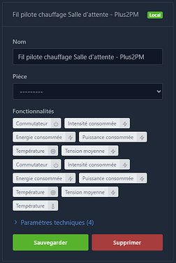

Gladys displays the transport actually used, device by device, with the graded badge and its reason when it is not the nominal path.
The device model is deduced, not hard-coded. Features come from the components that the device actually declares in Shelly.GetStatus, never from a model table. A Pro 1 gets an On/Off, a Pro 1PM gets metrology in addition — and a Shelly released after this code still works, as long as it speaks the documented vocabulary.
Covered components: switch, em, emdata, em1, em1data, pm1, temperature, humidity, devicepower.
