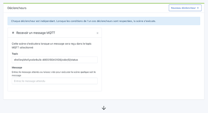

The tools offered here look great! But I have an issue: Shelly products publish to a topic and I can’t configure them differently… for example:
shellies/shellycolorbulb-485519DA31DB/color/0/status
Is there a way in gladys to listen to a specific topic? And not only gladys/master/device/…

It’s possible to do that in the scenes :slight_smile: There’s a trigger for that! It will be a bit of a hack though, but it can work

It’s possible to listen on a specific MQTT topic in Gladys in scenes:
This would allow you to trigger a scene if a Shelly device’s status changes.
That said, I agree it doesn’t replace an official integration, but it’s already an option while waiting for someone to propose development :slight_smile:
