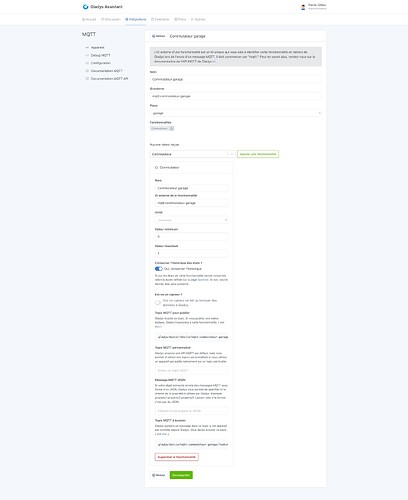

First you need to go to the « MQTT » integration and create this switch:

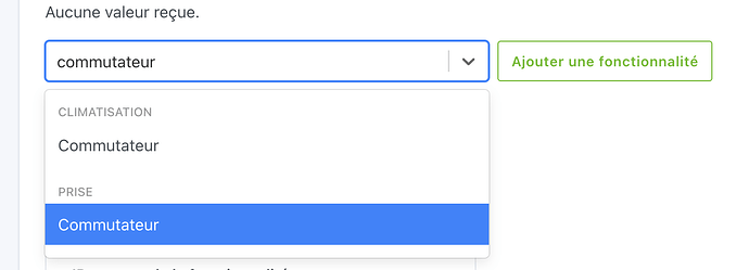

Give it whatever name you want, and add an « outlet - switch » feature:
This should give you this:
(Make sure to reproduce exactly what I did, uncheck « is this a sensor » in particular)

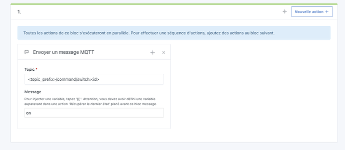

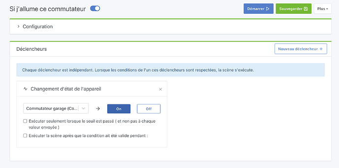

You’ll need to create 2 scenes, one for turning on, and one for turning off:
Turn on

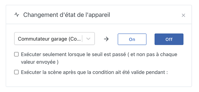

Create a trigger:
And an action:
Be sure to replace the « topic_prefix » and « id », I imagine you know them :slight_smile:

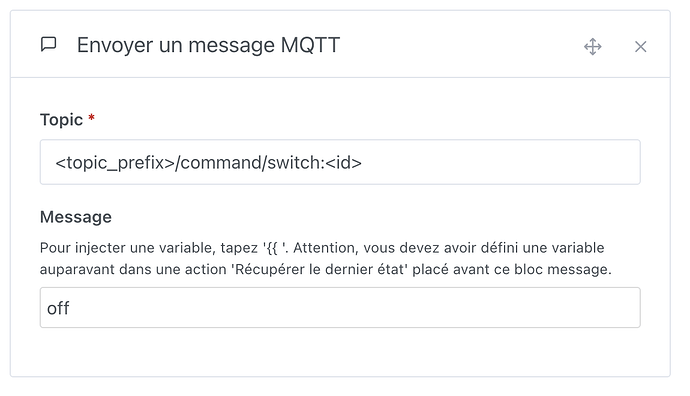

Turn off
Do the same, but with the off:
