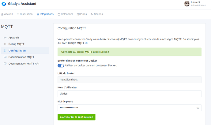

I am testing the connection with a Shelly product.
I can’t connect my Shelly device to the MQTT broker.
Connection with Gladys: no problem:
Shelly connection: impossible:
For info, I can connect perfectly with MQTTX.
