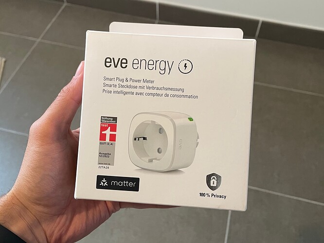

:bullseye: First test: a Matter / Thread smart plug
To move forward on this topic, I ordered a Eve Energy plug compatible with Matter on the Thread network.
It’s one of the highest-rated Matter devices right now! The Eve brand puts a strong focus on UX and privacy, which aligns perfectly with Gladys’s philosophy.

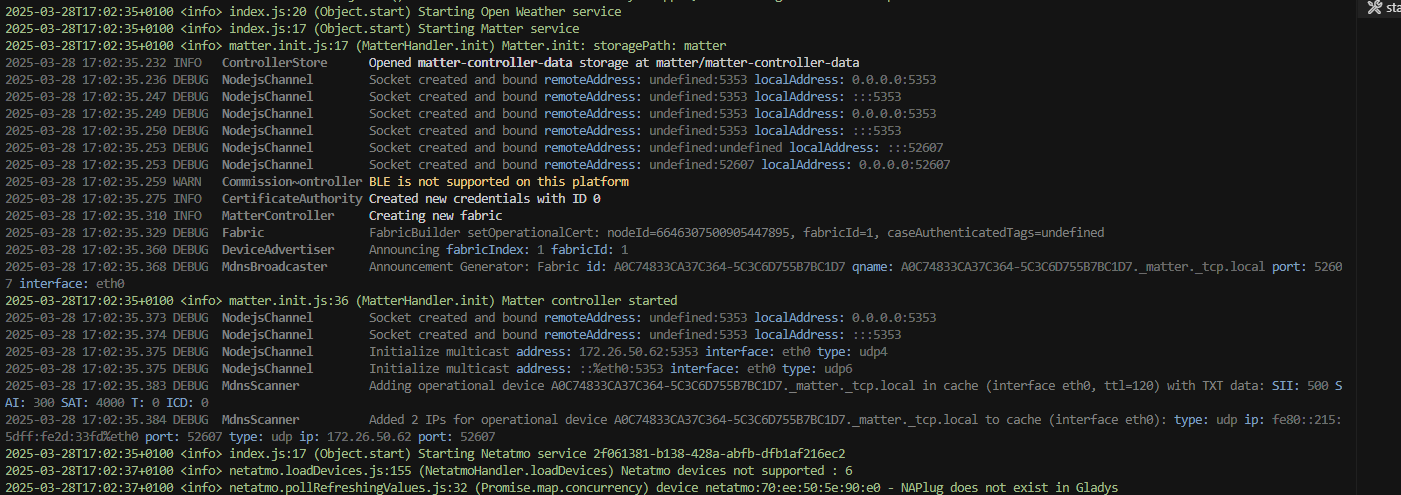

So
 It’s not working (the pairing code) but I suppose the reason is:
2025-03-28T17:19:53+0100 \u003cinfo\u003e matter.pairDevice.js:38 (MatterHandler.pairDevice) Commissioning device with options: {\"commissioning\":{\"regulatoryLocation\":0,\"regulatoryCountryCode\":\"XX\",\"regulatoryLocationType\":0},\"discovery\":{\"identifierData\":{\"shortDiscriminator\":15},\"discoveryCapabilities\":{\"ble\":false}},\"passcode\":63702205,\"commissioningTimeoutSeconds\":60,\"commissioningAttempts\":3,\"commissioningRetryDelayMs\":1000}
2025-03-28 17:19:53.938 INFO   PeerCommissioner     Commissioning device with identifier {\"shortDiscriminator\":15} and 1 scanners and knownAddress \"undefined\"
2025-03-28 17:19:53.938 INFO   ControllerDiscovery  Start Discovering devices using identifier {\"shortDiscriminator\":15} ...
2025-03-28 17:19:53.939 DEBUG  MdnsScanner          Registered waiter for query _S15._sub._matterc._udp.local with timeout 30 seconds
2025-03-28 17:19:53.939 DEBUG  MdnsScanner          Set 2 query records for query _S15._sub._matterc._udp.local: [{\"name\":\"_matterc._udp.local\",\"recordClass\":1,\"recordType\":12},{\"name\":\"_S15._sub._matterc._udp.local\",\"recordClass\":1,\"recordType\":12}]
2025-03-28 17:19:53.940 DEBUG  MdnsScanner          Sending 2 query records for 1 queries with 0 known answers. Re-Announce in 1.5 seconds
2025-03-28 17:19:53.942 DEBUG  NodejsChannel        Socket created and bound remoteAddress: undefined:5353 localAddress: 0.0.0.0:5353
2025-03-28 17:19:53.942 DEBUG  NodejsChannel        Socket created and bound remoteAddress: undefined:5353 localAddress: :::5353
2025-03-28 17:19:53.942 DEBUG  NodejsChannel        Initialize multicast address: 172.26.50.62:5353 interface: eth0 type: udp4
2025-03-28 17:19:53.943 DEBUG  NodejsChannel        Initialize multicast address: ::%eth0:5353 interface: eth0 type: udp6
2025-03-28 17:19:55.441 DEBUG  MdnsScanner          Sending 2 query records for 1 queries with 0 known answers. Re-Announce in 3 seconds
2025-03-28 17:19:58.441 DEBUG  MdnsScanner          Sending 2 query records for 1 queries with 0 known answers. Re-Announce in 6 seconds
2025-03-28 17:20:04.442 DEBUG  MdnsScanner          Sending 2 query records for 1 queries with 0 known answers. Re-Announce in 12 seconds
2025-03-28 17:20:16.443 DEBUG  MdnsScanner          Sending 2 query records for 1 queries with 0 known answers. Re-Announce in 24 seconds
2025-03-28 17:20:23.940 DEBUG  MdnsScanner          Finishing waiter for query _S15._sub._matterc._udp.local, resolving: true
2025-03-28 17:20:23.940 DEBUG  MdnsScanner          Removing last query _S15._sub._matterc._udp.local and stopping announce timer
2025-03-28 17:20:23.940 INFO   ControllerDiscovery  Found 0 devices using identifier {\"shortDiscriminator\":15}
I’m stuck on my Linux (dev on Windows).

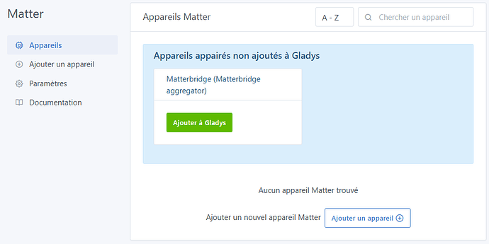

Network logs:
        "name": "Matterbridge (Matterbridge aggregator)",
        "external_id": "matter:18303769249106620906:1",
        "selector": "matter:18303769249106620906:1",
        "service_id": "1404ff11-4863-47e4-8060-dd25844b67e4",
        "should_poll": false,
        "features": [],
        "params": []
A lot of other things in the [
] but too heavy to send here

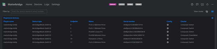

I put the logs for you after stripping the Function entries from the objects:
2025-03-28T19:59:41+0100 \u003cinfo\u003e matter.init.js:36 (MatterHandler.init) Matter controller started
convertToGladysDevice gladysDevice
Aggregator {
  clusterServers: Map(1) {
    29 =\u003e {
      _type: 'ClusterServer',
      attributes: [Object],
      commands: {},
      events: {},
      datasource: [Getter/Setter],
      _assignToEndpoint: [Function: _assignToEndpoint],
  clusterClients: Map(1) {
    29 =\u003e {
      revision: 2,
      _type: 'ClusterClient',
      supportedFeatures: [Object],
      isUnknown: false,
      endpointId: 1,
      events: {},
      commands: {},
      subscribeAllAttributes: [AsyncFunction: subscribeAllAttributes],
  childEndpoints: [
    ComposedDevice {
      clusterServers: [Map],
      clusterClients: [Map],
      childEndpoints: [Array],
      number: 2,
      uniqueStorageKey: undefined,
      structureChangedCallback: [Function: structureChangedCallback],
      descriptorCluster: [Object],
      deviceTypes: [Array]
    ComposedDevice {
      number: 5,
    ComposedDevice {
      number: 9,
    ComposedDevice {
      number: 13,
    ComposedDevice {
      number: 15,
    ComposedDevice {
      number: 17,

I think that because it’s a gateway, it’s constructed differently. Maybe focus on your modules for the moment and revisit bridges in a future PR?
In any case, in the file convertToGladysDevice under device we do receive the devices registered in the bridge via: device.childEndpoints[] because the properties of the objects in the array include in device.childEndpoints[].ComposedDevice.number the endpoint numbers of the Shelly
To investigate further in the next episode or whenever you want.
I still think it would be good to understand how it’s architected, just to be sure we don’t go down the wrong path regarding the format of the external_id :slight_smile:
Can you try to have the « simplified Â» format of your single Node?
We should think about what the external_id of such a device looks like

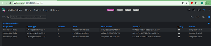

Hi @pierre-gilles,
I’ve looked but
 ^^ I still don’t know how to access the devices behind a bridge.
By adding the following function in server/services/matter/lib/matter.pairDevice.js after the this.devices.push(gladysDevice);:
        const childEndpointsCount = device.childEndpoints?.length || 0;
        if (childEndpointsCount > 0) {
          logger.debug(`Processing ${childEndpointsCount} child endpoints for device ${device.number}`);
          await Promise.each(device.childEndpoints, async (childEndpoint) => {
            console.log('pairDevice childEndpoints');
            console.log(childEndpoint);
            const childDevice = await convertToGladysDevice(
              this.serviceId,
              nodeDetail.nodeId, // Unique ID for the child device
              node,
              childEndpoint, // The child endpoint is treated as a device
              nodeDetail.deviceData,
              nodeDetail.unique_id
            this.listenToStateChange(nodeDetail.nodeId, childEndpoint);
            this.devices.push(childDevice);
Here’s an example of a device « childEndpoints Â»:
childEndpoints: [
    PairedDevice {
      childEndpoints: [],
      number: 3,
      deviceTypes: [Array],
      declineAddingMoreClusters: true
    PairedDevice {
      childEndpoints: [],
      number: 4,
  number: 2,

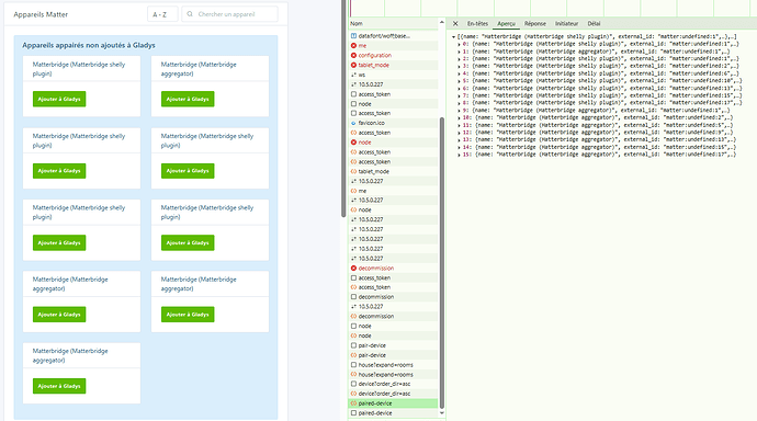

And I have
But well, I don’t know if that helps
However, I was looking into the issue of keeping a device’s states even after decommissioning (but you may have solved that in the meantime ^^), shouldn’t we use the uniqueId for the external_id:
matter:${nodeDetail.deviceData.basicInformation.uniqueId}:${device.number} and only keep the nodeId in a param?
EDIT: Don’t hesitate to tell me if you want us to do a screen-sharing call.

Hello @pierre-gilles,
I don’t necessarily agree — if we look at the device level, the nodeId is not fixed. It is even considered a « temporary Â» bridge. Any cause that leads to a re-pairing results in a change of nodeId.
The uniqueId itself remains fixed as far as I can read/observe.
Proof of this: below I installed 2 matterbridge on 2 distinct networks, and I was able to pair my Shelly on the 2nd platform. For info, there was also a power cut in the meantime, so I’m certain those devices restarted.
The UniqueID are exactly the same, the serialNumber as well. And on each re-pairing with MatterBridge (uninstalling the matter-shelly plugin or restarting) they « re-pair Â» identically.
And finally, you can always use the serial number instead. The serieNumber is accessible in the same place, it seems to me. Because the nodeId is not a device ID.
Concrete example: your device is paired according to your method. You have another thread next to it that also references it — when you connect it you will have a second identical referenced device because it will depend on the nodeId of that other channel
For me, the nodeID is a parameter that will need to be updated when it changes.
I might be wrong — you’d need several platforms to test the unique ID.
But for the serial number
 there’s no reason it would be different from one platform to another, is there?
I think we should check the official recommendation and see how the other platforms handle it :slightly_smiling_face:
Matter is a standard, it’s not up to us to make those decisions!

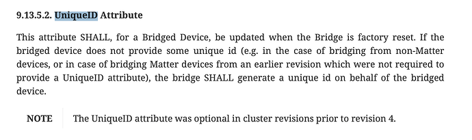

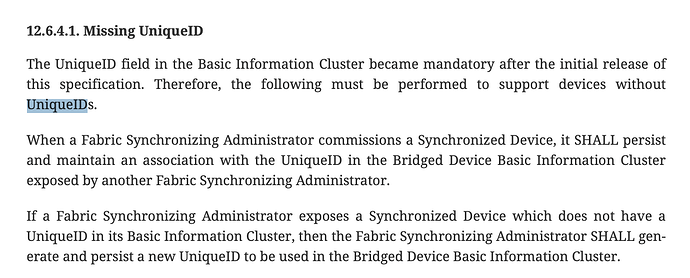

I’m currently reading the Matter 1.4 specification.
There are over 1000 pages, but at least everything is described, it’s very clear.
Already, the field uniqueId was not mandatory before Matter 1.4, it’s a recent addition. There are therefore devices in the wild without uniqueId.
In the case of the « Bridge Â» device as in your case @Terdious, the uniqueId is not stable over time according to what the spec says:
In general, I have the impression that a device identifier is the combination of 3 attributes:
  • FabricIndex
  • NodeId
  • Endpoint
We weren’t far off but it was missing the FabricIndex because a NodeId can exist in another Fabric, I think.
My opinion
The uniqueId field is not a stable basis for identification from what I read in the specification.
However, nothing prevents us from saving this uniqueId if it exists (in a param for example), and then doing the matching in case of commissioning a device that has apparently already been commissioned in Gladys!

if you need additional info about other products, I set up a matterbridge with the Tahoma gateway to retrieve all my roller shutters and blinds.
I won’t be able to help on the dev side but if you need details about a device, I can provide them :slight_smile:
PS: I also imported my Zigbee devices so we have a few more features for other devices for later.
