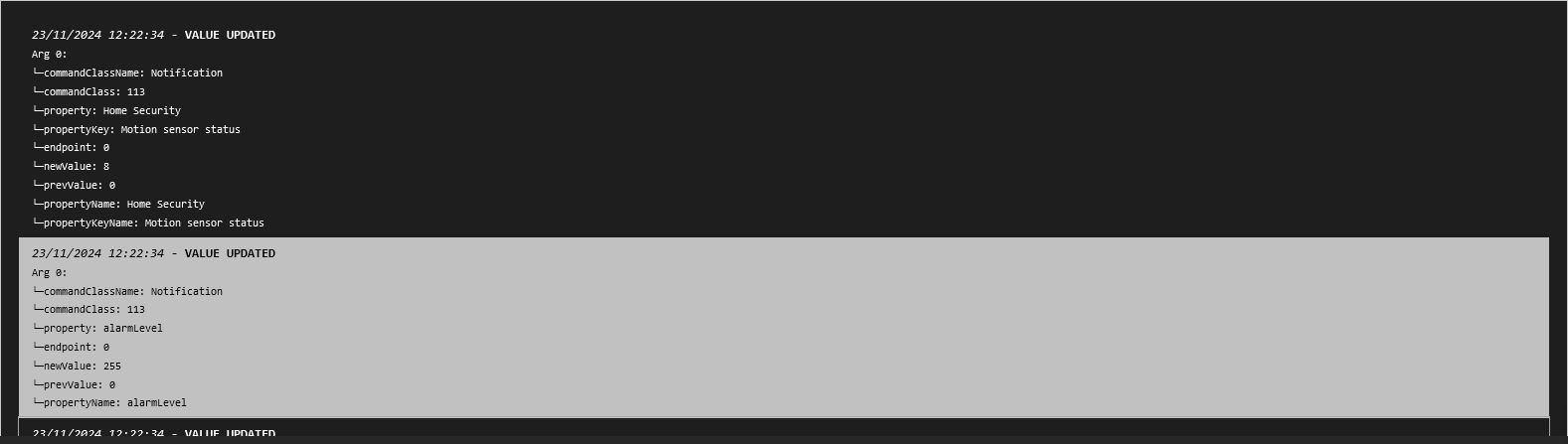

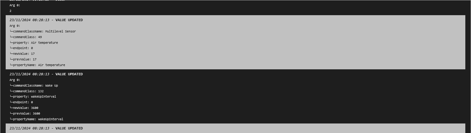

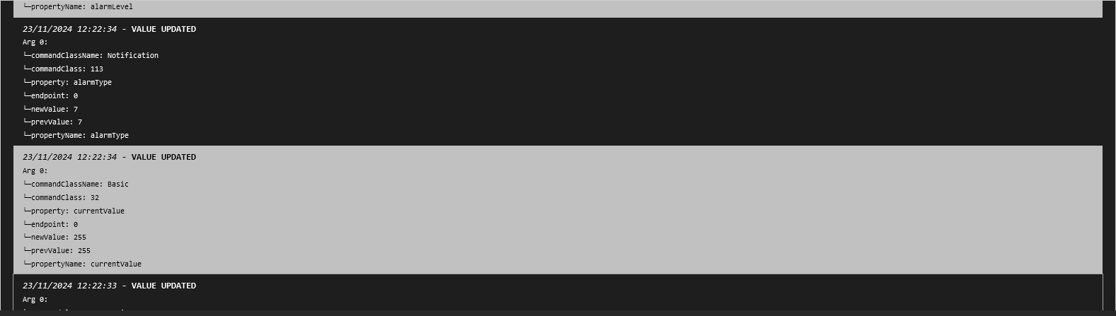

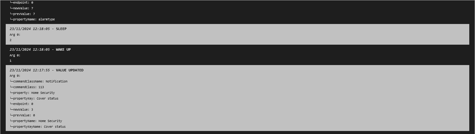

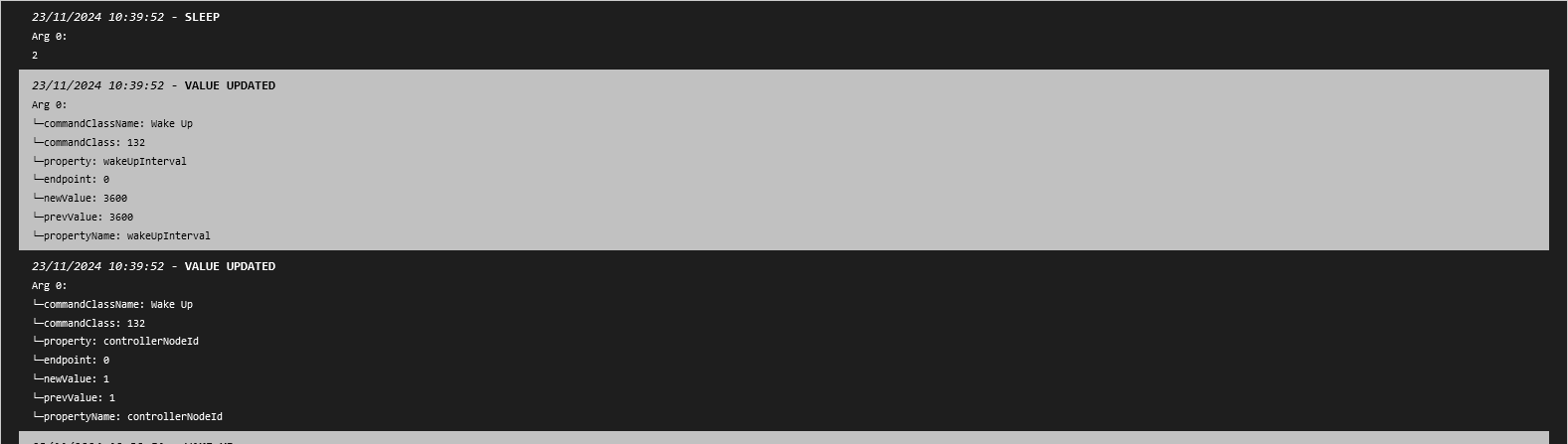

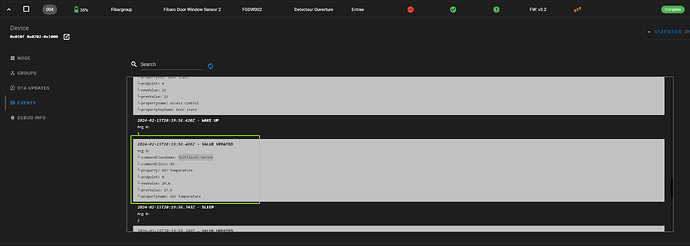

@gaetanb76 could you show us the « events Â» screen and display a « Value updated Â» to see what the messages ZwaveJS UI sends look like?
Example:
Hi @pierre-gilles,
Here are the messages I was able to find:
Link to the PDF doc:
https://www.zipato.com/wp-content/uploads/2015/09/vs-zp3102-Zipato-Multi-Sensor-Dual-User-Manual-v1.4.pdf
The alarm indicates when the rear cover has been removed.
