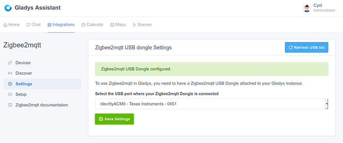

I retested this morning and it works well on my end with a device that is /dev/ttyACM0 on my host machine. But there must be an issue if the device name is different. I’m investigating :thinking:
2021-02-02_08-37
2021-02-02_08-43
On my machine, it’s the opposite, it’s on ttyUSB0 on the host side.
Do you have these lines in the Gladys container (but with /dev/ttyUSB0)?
2021-02-02_08-43
Yes exactly, that’s right.

Did you delete the config files in /var/gladysassistant because as far as I remember, you manually modified the Z2M config file, I think?
There should be /dev/ttyACM0 in the config
Well spotted!! Damn, I forgot about this modification during the last debug.
Thanks @reno and @cicoub13 for the time spent!
The containers now launch super fast and without any issues.

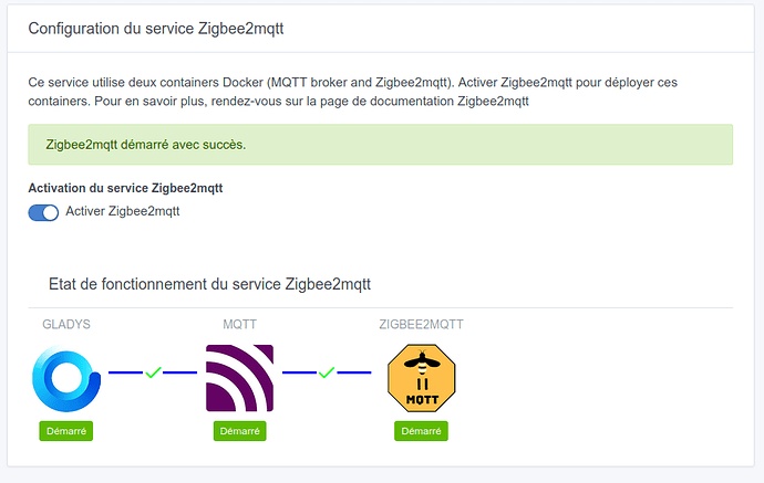

However, no equipment is detected in Gladys, contrary to what the mqtt container indicates?!
Is everything okay on the configuration page http://gladys-ip:1080/dashboard/integration/device/zigbee2mqtt/setup?
Can you provide the logs of the two containers?
Premier problème (résolu) : dysfonctionnement entre mqtt et Gladys
En fait la page de configuration affiche rĂ©gulièrement que tout est OK, mais depuis mon ordi j’ai remarquĂ© que ça « saute Â» rĂ©gulièrement.
C’est donc le conteneur mqtt qui semble en cause :
1612425253: New connection from 127.0.0.1 on port 1884.
1612425253: Client gladys-assistant-main-instance already connected, closing old connection.
1612425253: New client connected from 127.0.0.1 as gladys-assistant-main-instance (p2, c1, k60, u'gladys').
1612425258: New connection from 127.0.0.1 on port 1884.
1612425258: Client gladys-assistant-main-instance already connected, closing old connection.
1612425258: New client connected from 127.0.0.1 as gladys-assistant-main-instance (p2, c1, k60, u'gladys').
Une fois tous les conteneurs redémarrés, cette erreur disparait.
