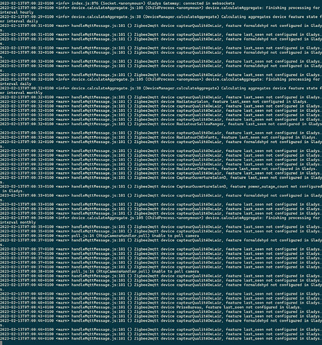

I’ve just updated to v4.17.0 and I’m seeing Zigbee2MQTT errors.
This is probably related; I can no longer control my Zigbee devices since the update, but the Gladys interface works.

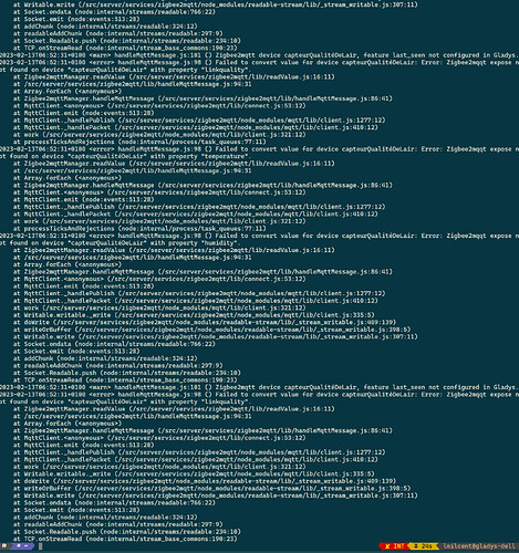

Hi, I have the impression that the error simply says that Gladys receives a value from zigbee2mqtt, but that value is not handled by Gladys.
Can you try to update your device from the « Zigbee Discovery » page of the Zigbee2Mqtt service?

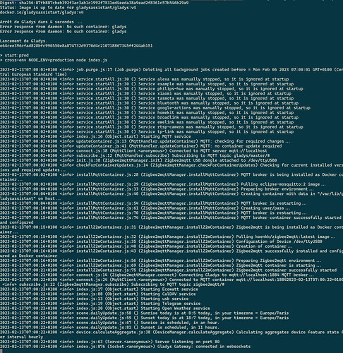

I’d do:
docker logs gladys \u0026\u003e gladys_logs.txt
https://linuxhint.com/redirect-stdout-and-stderr-to-file/
That’s a looooot of logs, but it does work indeed.
However, MQTT was updated on my system yesterday… Maybe related?

However, none of my integration devices have been updated since the restart following the Gladys update. I’ll check the logs when I get home tonight to provide information for the discussion.

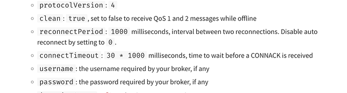

I’m replying to myself — from reading the code and the MQTT.js docs, it seems that if the connection doesn’t happen within the first 30 seconds, it’s game over
On the Zigbee2mqtt integration side in Gladys:
(Source: Gladys/server/services/zigbee2mqtt/lib/connect.js at master · GladysAssistant/Gladys · GitHub )
On the MQTT.js docs side:
Doc: https://www.npmjs.com/package/mqtt#connect
In some cases, if MQTT is updated just after Gladys is updated (which makes sense — Watchtower does everything in series at the same time), and if the update takes more than 30 seconds (quite possible if the user’s internet connection isn’t great), the user will no longer have Zigbee2mqtt available
Needs testing in real life, but I think this is what’s happening.
@AlexTrovato what do you think?
In my opinion, we need to have a real reconnection strategy even before the first connection in case it fails — we should see if there’s a recommended way to do this with that lib, to retry every 15 seconds « ad vitaam »?
