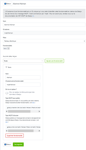

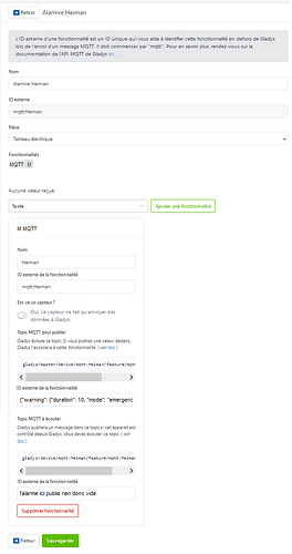

So the idea would be to have the ability to create a device in the MQTT integration that would react to a dedicated MQTT subscription to transform it and use it in Gladys and allow Gladys to publish to it without having to go through Node-RED
so move from a « text » device
to a pure MQTT device

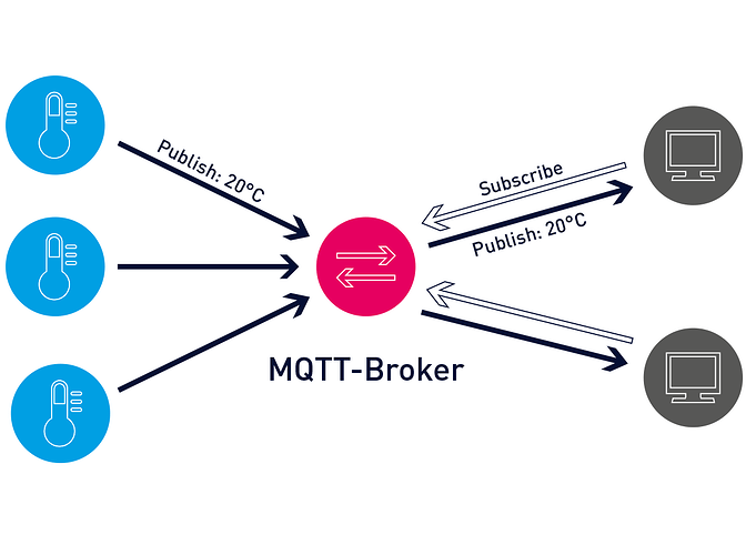

I understand that on one side we have devices (sensors, plugs, etc.) that communicate using a radio protocol, Zigbee, which is hardware-wise to a gateway dedicated to the vendor or to a generic dongle (Conbee, Deconz, Sonoff) which allows bypassing the vendor gateways to a TCP protocol which is MQTT (similar to a network card on a PC).
I understand that this MQTT protocol transmits TCP frames to a broker (dedicated http server) MQTT and does so bidirectionally.
That this broker works in the manner
  • I receive such an MQTT message (topic) with content (payload) I forward to the people who subscribed to that message(topic) in the list of subscriptions that I have the value of the message (payload).

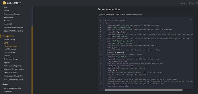

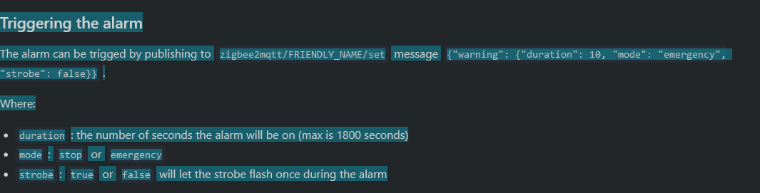

    In the case of the alarm, looking at the docs I see
So you must send (publish) to the topic
zigbee2mqtt/FRIENDLY_NAME/set
the message
{"warning": {"duration": 10, "mode": "emergency", "strobe": false}}
Isn’t it?

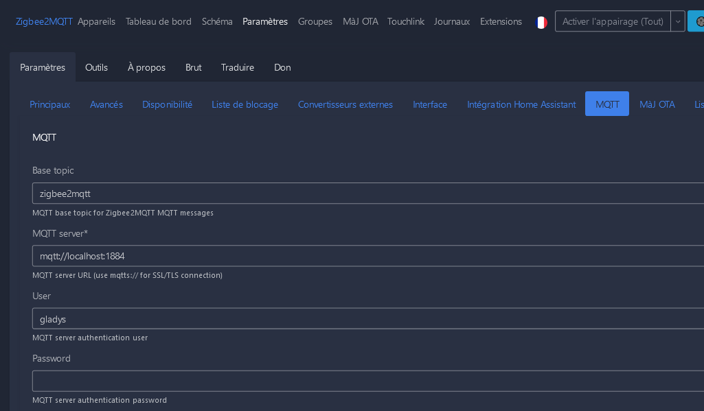

To summarize, yes there are 2 MQTT brokers.
1 dedicated to zigbee2mqtt and another for the MQTT integration.

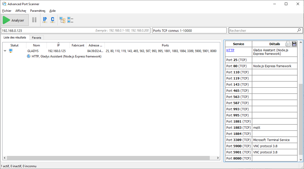

Indeed, I thought the configuration in zigbee2mqtt pointed to the MQTT server installed by Gladys, but in fact it points to the MQTT server that the container itself hosts.
By looking at the open ports I understood that there was port 1883 for the MQTT broker of the MQTT docker
and port 1884 for the MQTT broker of the Zigbee2Mqtt container
I hadn’t grasped the need for the duplicate MQTT broker, then I understood by looking at the different integration codes on GitHub that the MQTT broker of the zigbee2mqtt docker only serves to translate between Gladys’s own syntax and that coming from zigbee2mqtt in the zigbee2mqtt container.
So basically, when a device is integrated in the zigbee2mqtt integration of Gladys there is a correspondence made between (to reuse the alarm example) the Gladys syntax
gladys/master/device/mqtt:Heiman/feature/mqtt:Heiman/text
and the zigbee2mqtt syntax
the sending (publish) to the zigbe2mqtt broker with the topic
and payload
at least when the device has been integrated, is that correct?
