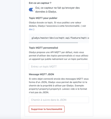

Following our discussion with @Alyafride, I went for an interface that looks like this:
Nothing definitive, I just started 2 minutes ago :stuck_out_tongue:

In terms of UI I would have imagined a switch at the device level to define whether the payload is of type JSON or « sub-topic » and optionally to set the parent topic. Then at the feature level define the JSON path or the sub-topic (not sure that combining both simultaneously is necessary)

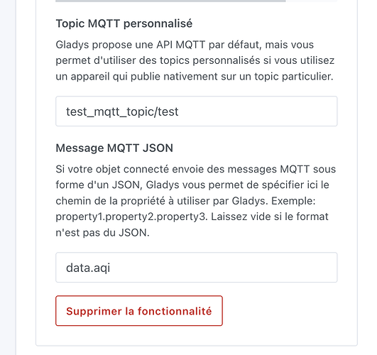

First successful test !
I created a device that listens on this topic with a JSON body :

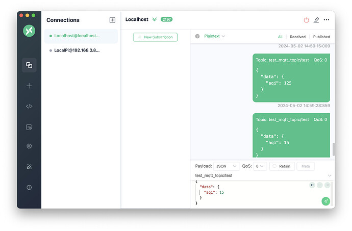

I send this JSON body :

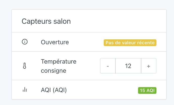

Available in the UI :
There is still work to do, because currently the MQTT integration does not support multiple listeners on the same topic, which would prevent using the same topic across multiple features, which is inconvenient in the case of this feature

On one hand, since the MQTT topic for devices often contains a unique ID (the device’s serial number or its MAC address), it seemed simpler to define it only once at the device level, but that has a heavier impact on the interface.
On the other hand, it offers more flexibility to specify the full topic each time and has less impact on the interface. However, it implies a « JSON path » field which can be confusing if the metrics are emitted « flat ».
For me it should be at the feature level — we don’t know how each brand works ^^

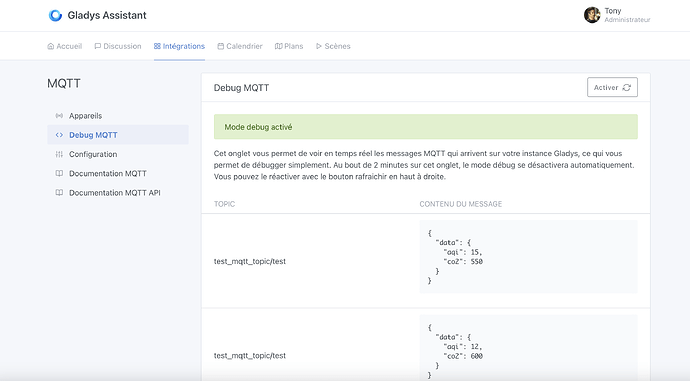

I’ve finished the feature, and I’m currently adding a « Debug MQTT » tab which will make it easier to understand what’s happening on the instance:
That way the user isn’t left in the dark if it doesn’t work :slight_smile:

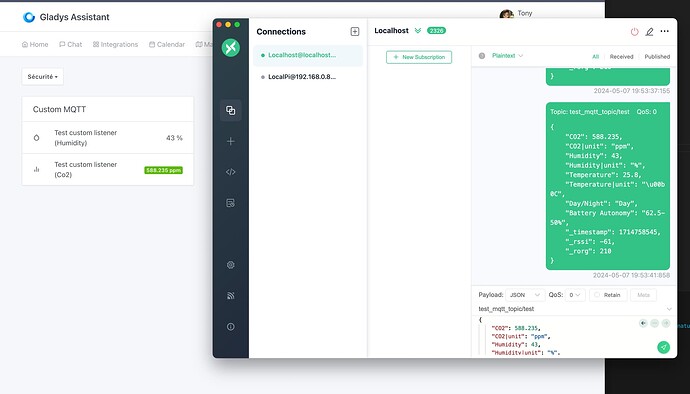

I just tested, it works for a device that posts with a topic/metric. However, for a device that posts different metrics within a JSON, only the first « feature » works; the second, configured on the same topic but with a different JSON path, does not retrieve any data. Ex of data:
{"CO2": 588.235, "CO2|unit": "ppm", "Humidity": 43.0, "Humidity|unit": "%", "Temperature": 25.8, "Temperature|unit": "\u00b0C", "Day/Night": "Day", "Battery Autonomy": "62.5-50%", "_timestamp": 1714758545, "_rssi": -61, "_rorg": 210}

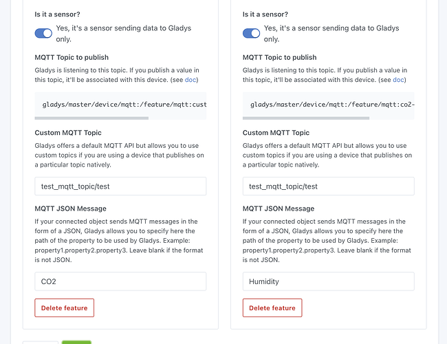

However, I tested the case of having multiple metrics within the same JSON and it works well:
The configuration:

That seems good to me now :slight_smile: I tested it in JSON and the metric « flat ».
