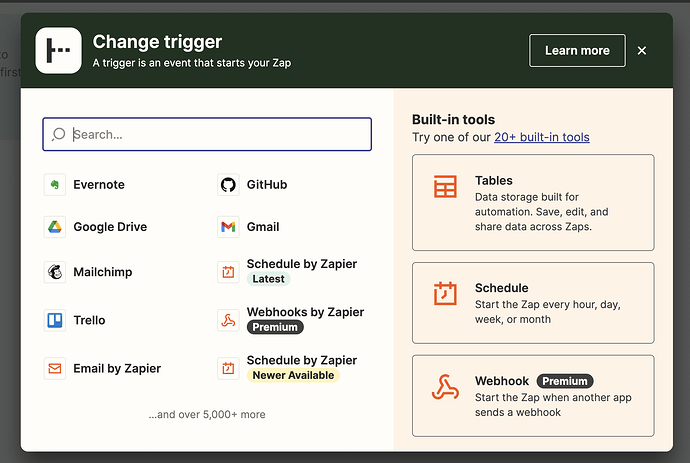

If we take the example of Zapier (https://zapier.com/), when you select a trigger, they offer all the possible technologies directly so it’s clear:
I think we can mention MQTT in this case and talk about MQTT throughout the code without problems :slight_smile:
