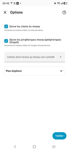

I’m looking in HA how it’s presented :wink:
I don’t remember anymore ^^
Here you go to get started!^^

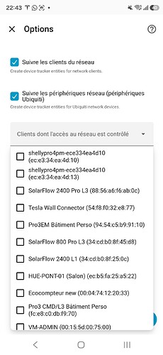

One option per type, which already allows you to see the first base of devices!
And then, as I thought, a selector (which will need to be innovated, that’s for you @pierre-gilles ^^, because we can do better, that’s for sure, like for example a selector with a search field)
Could we even have a « Connected Clients » selector and a « Disconnected Clients » one?
(In my logs, there are about 400 connected, for example)
1 pre-checked box for « Infrastructure(s) »,
1 pre-checked box for wlan(s)
1 pre-checked box for Connected Clients with selector
1 pre-checked box for Disconnected Clients with selector
I don’t know what you think about it?
In itself, even without development, it’s possible to have the beginning by replacing the selector with a text field where you enter your client IPs separated by « , » or « ; »

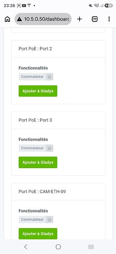

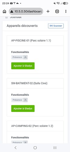

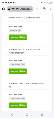

Et paf!! We’re good for the infra!! And for the networks!! But :sweat_smile: it even goes to the port, but it makes a device per switch port… :sweat_smile::zany_face: It’s a total mess here ^^
A switch feature per device port would be awesome!!!
But otherwise, it’s great.

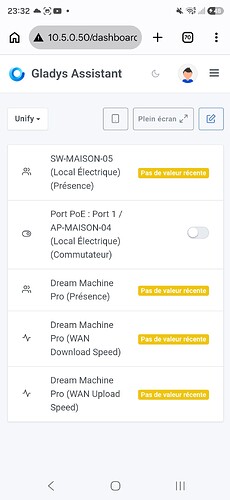

Dashboard status return /cmd:
I don’t understand… Are you talking about the « No recent value » status returns?
New version 1.5.2:
  • A 24-port PoE switch now generates 1 single Gladys device (containing 25 features: Status + 24 PoE ports) instead of 25 separate device cards.
  • The local IP address and MAC address appear in the Settings tab of each device card in the Gladys interface.
  • If the equipment (e.g., UCG fiber or Dream Machine) has PoE ports, a single dedicated device named PoE Switch: Cloud Gateway Fiber (the device’s defined name) is generated. It groups all PoE ports with their explicit names: Port 1 (Entrance Camera), Port 2 (Living Room AP), etc.

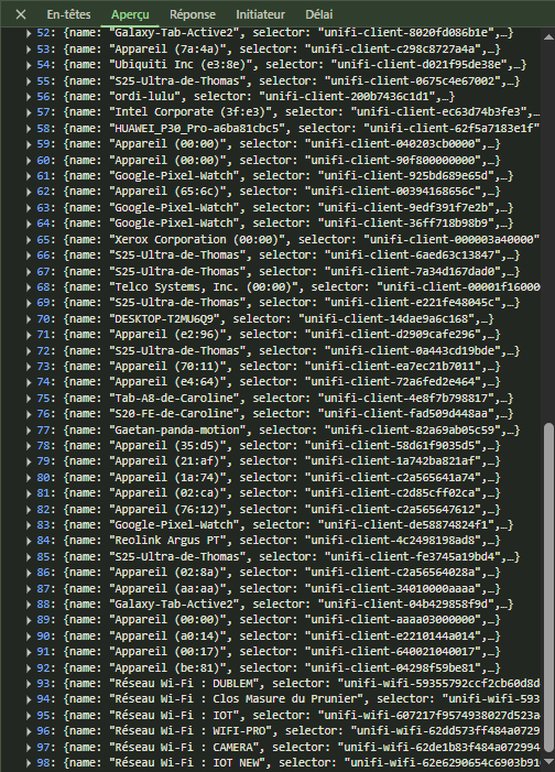

No no, I was talking about the list of 400 connected clients on the network in the discovery ^^
After retesting, I understand your question, you’ve chunked the discoveries, but it doesn’t work, that’s what I told you before ^^ In fact, if you chunk, your container returns the request discovered_device three times
But then, for each one on Gladys’ side, it replaces the previous list. So by doing that, you only get the last chunk:
In short, now I only see the last 99 devices from the complete list. But you can’t do anything about that on your side :sweat_smile:
The only possible solution right now, as I told you, is:

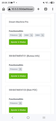

Thanks for this 1.5.2 :+1: I restarted a complete discovery on my infrastructure (UDM Pro, several 8 and 24 port switches, several SSIDs). Here are my feedbacks, I went to look a bit into your code to help you with the localization of the points.
1. 8 Port Switches: Duplicated Equipment, and 4 Ports Out of 8
The network presence of the equipment and the PoE ports arrive as two distinct Gladys devices (unifi-gateway-<mac> and unifi-poe-switch-<mac>, same MAC):
I see in src/devices/index.js that this is intentional: for each infrastructure device you push gatewayBlueprint.buildDevice(), then poeSwitchBlueprint.buildDevice() if hasPoePorts. Is this an intentional choice?
From my user perspective, a switch = one piece of equipment in Gladys, with the presence + the ports as features. Two cards for the same hardware, it clutters the list (and at my place it quickly doubles the number of devices, a subject we had already encountered in post 20 with the 200 device limit). If you want to keep the separation for those who prefer it, a config option merge_switch_devices (default: merged) would do the job. Be careful though: merging changes the external_id, you will need to plan a migration for those who have already named/sorted their devices.
For the 4 ports out of 8: after reading src/devices/poePort.js, it makes sense, you filter on
if (port.poe_caps && port.poe_caps > 0 && port.port_idx).
My USL8LP8 (UniFi Switch Lite 8 PoE) indeed has 8 ports of which only 4 are PoE — so the behavior is correct if the goal is PoE control only. This is therefore not a bug, but two remarks:
  • it’s not obvious for the user: a small note in the README (« only PoE ports are exposed ») would avoid doubt;
  • it would be great to expose all ports with what makes sense per port: link state (up/down), negotiated speed, and port activation/deactivation if the API allows it — PoE control remaining reserved for PoE ports. There we would have a real switch vision.

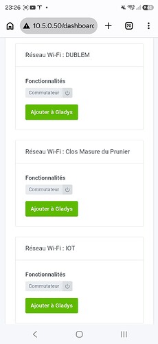

4. Wi-Fi Networks
RAS, it works well: each SSID arrives with a switch, and it cuts/activates the complete network as expected. A few ideas if you are looking for material:
  • the number of connected clients per SSID (numeric feature, great for scenes and history);
  • exposure of the guest network / the possibility to regenerate a guest password;
  • possibly activation per access point rather than globally.

I’d still like to answer you on one point (in case you ever want to make PRs), that of duplicated equipment. Actually, it’s intentional, but it’s because in my first attempts, if I didn’t duplicate the devices, I ended up with something like this:
  • DEVICE 1
    • Presence
    • Upload speed
    • Download speed
    • Switch
    • Switch
    • Switch
    • etc…
With the impossibility of distinguishing the switches from each other.
