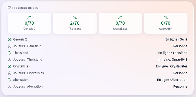

So, with your help, I managed to find the other cards! You just need to add 1 to the port number to query the next card.
However, it’s a shame that we’re limited to 4 cards simultaneously. What if a game has more than 4? I also wonder about managing multiple different games on the same installation.
Regarding the display, I find it still not very intuitive. Currently, two options are proposed:
  • A display per card/server, depending on the game.
  • A display grouping the 4 cards/servers on the same widget.
The second option is not very readable and lacks clarity. The presentation should be revised a bit so that the information is easier to understand.
I don’t yet have a precise idea of the best way to present all this, but one thing is certain: in its current form, the display doesn’t really suit me.
Here are my first impressions!
