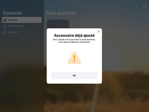

and this error on iPad when I try to add Gladys (even though I had removed it)
After deleting the variables in t_variables in the database, I was able to re-associate Gladys.

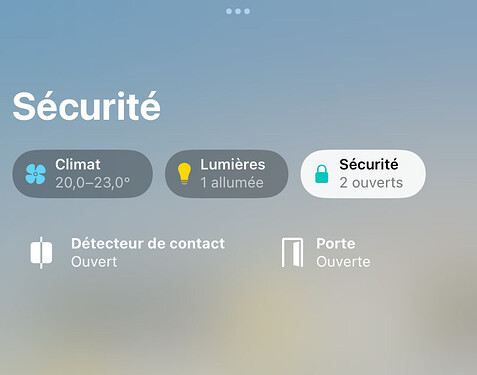

The contact sensors are reported correctly (and can be displayed as doors).
But the same errors remain in Gladys and the state of the contact sensors does not change in HomeKit (it even seems inverted)

On the HomeKit forums I’ve seen quite a few cases like that. I have the impression that the deletion directive doesn’t always propagate up to the device, so the device disappears from your Home app but not from the device’s internal configuration. I will add a réinitialiser button on the integration page to delete the configuration folder; that should make it unnecessary to go into the table if we encounter this message.

There you go — I created an image for you with the fix for the inverted value and for sending the value live. Can you tell me if it’s good?
All good for me, thanks for the correction

The issue we discussed with Cyril is a particular case that I will handle in another PR. We need to handle the case where the user tries to unpair Gladys from HomeKit but it’s not reachable on the network at that time. On the Home app side Gladys is forgotten but on Gladys’s side it doesn’t know that it needs to remove the pairing, so a reset is necessary (see FAQ · homebridge/HAP-NodeJS Wiki · GitHub).
