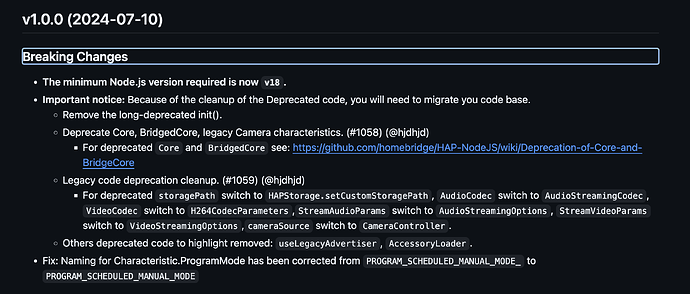

I just opened a PR updating the main dependency of this service hap-nodejs. We’ve moved to a stable version of the library, including major optimizations to prevent congestion on your local network.

Another question, did you see the CHANGELOG with the breaking changes since our version?

Yes, I’ve checked everything, it’s all good
