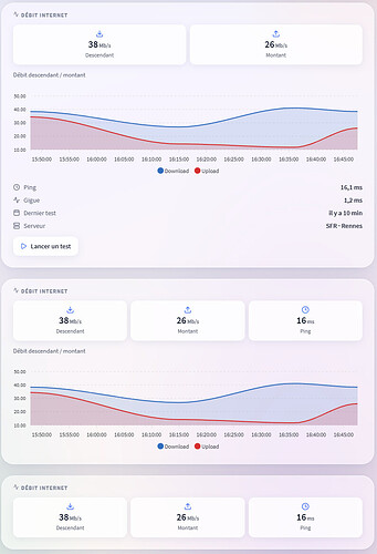

However, I find that the display in the interface might be a bit too detailed for some use cases. It would be interesting to be able to choose between three display levels:
  1. Full mode: all available information (upload and download speeds, ping, server, etc.).
  2. Intermediate mode: three boxes displaying upload and download speeds as well as ping, accompanied by the graph to visualize performance evolution and possibly identify outages, if the data allows.
  3. Compact mode: only upload and download speeds and ping, for a more discreet display on the dashboard.
This would allow everyone to adapt the widget to their needs and the available space on their dashboard, while still providing access to detailed information for those who want it.

@Prof_Techno it’s done in 1.5.0 :slightly_smiling_face:
In the widget settings, a new Display option:
  • Full (default): as before;
  • Speeds, ping and graph: three boxes (download, upload, ping) and the graph;
  • Speeds and ping: just the three boxes.
The two short versions no longer have the button: a test is always launched from the integration configuration. Update from Gladys and let me know how it goes!

Well spotted @Damien! That was intentional: for the short modes, I chose to remove the button (and the date) to keep a really compact widget. But since everyone has their own use case, 1.6.0 adds a setting per widget, Button « Run a test »: as before, always, or never. You can put it back on your reduced widget :slightly_smiling_face:
@Prof_Techno thanks for the screenshot :slightly_smiling_face:
Outages: honestly, the graph isn’t designed for that. Tests run every hour by default (minimum 10 minutes), a failed test sends no value, and the graph connects the dots: an outage between two tests isn’t visible.
