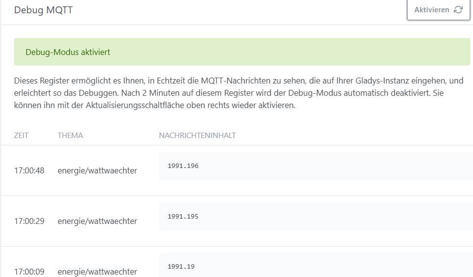

On my electricity meter (in Germany, the energy supplier’s delivery point), I can view the reading to the second.

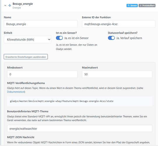

In Node-RED, I now query this meter every 15 minutes and send the data to Gladys via MQTT. Here’s what it looks like:
Translated with DeepL.com (free version)
I set up a virtual device in Gladys, I retrieve the MQTT topic and I set up energy consumption monitoring from there. Let’s see… I hope (for me and for you) to have correctly understood the difference between energy and power. Regards, Thomas

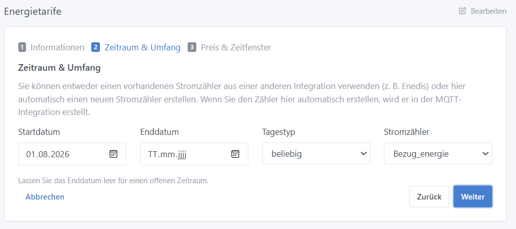

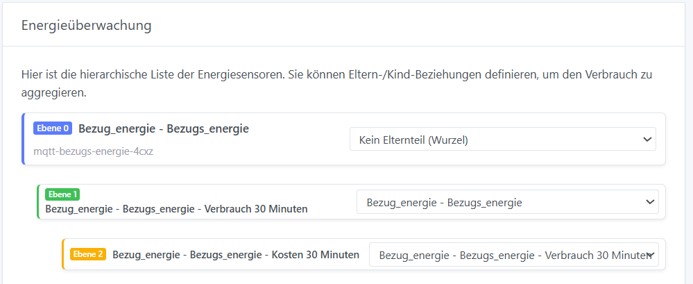

Sorry, I forgot… Here’s how the data is displayed in Gladys. For now, it’s like this, then every 15 minutes:
Awesome, is everything working now? :slight_smile:
Yes, thank you again (P.S.: Deep L is more powerful and more accurate for translation :wink: )
