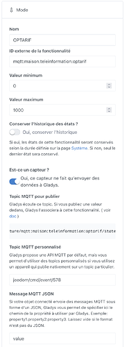

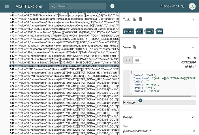

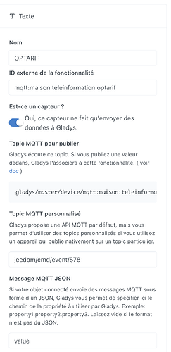

1. Retrieving a value coming from Jeedom
From Jeedom I publish values from la téléinfo that I retrieve. I can retrieve the numeric values (from object 579 for example), but it’s impossible to retrieve the value of object 578 to display it on my dashboard (OPTARIF) :
I tested as an object Text or Mode and neither works.

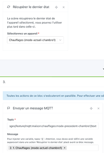

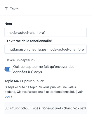

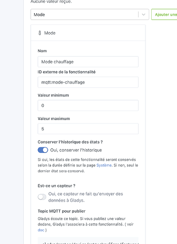

2. Retrieving a text to send it to another MQTT object
For my heating, I send a text value to MQTT (Confort for example) :
When I retrieve it, I get a null value… which I send back to MQTT instead of being able to resend the original text.
And tonight I finally understood why I couldn’t retrieve this text: I was using the « Get last state » block and that block doesn’t retrieve text but only numeric values :frowning:

I found this post Permettre la recuperation de data de type text ou alpha! but the final solution doesn’t mention retrieval via scenes, only the dashboard.

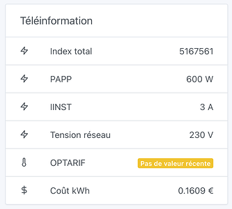

In particular a piece of info from my TIC frame which is OPTARIF. The frame is currently not correct and sends me OPTARIF=BASE whereas I’m in TEMPO. So I want to monitor this info from Gladys to then work on TEMPO-oriented graphs (HCHP/BleuRouge/Blanc) with the correct indices from the frame.
I admit it, nothing generic about my request, but it’s only for me for a short period of time (I hope) :sweat_smile:

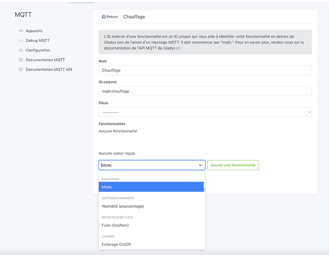

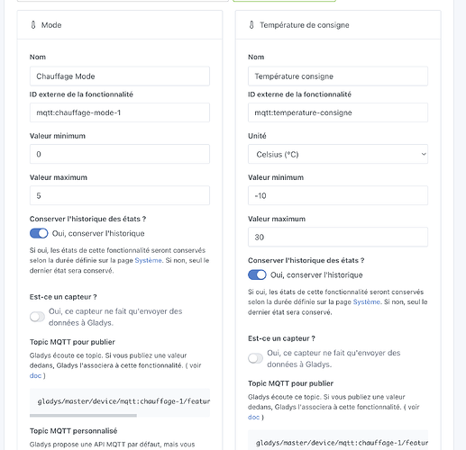

In the MQTT integration, you create a device.
You add a capability « Heating - Mode »:

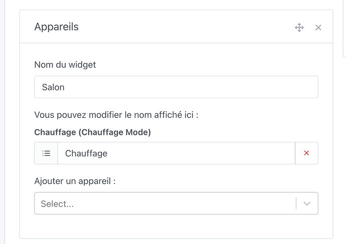

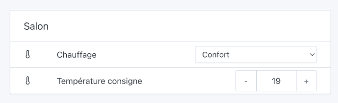

Which you can then display on the dashboard:
And control it :slight_smile:

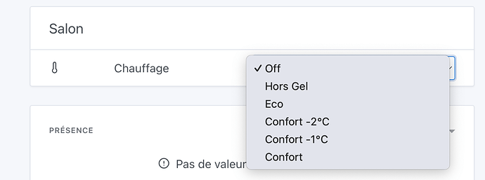

If you want Jeedom to react to MQTT events, you can subscribe to the MQTT topic in Jeedom provided by Gladys.
And then you’ll receive 6 events with 6 possible values:
Off → 0
Frost protection → 1
Eco → 2
Comfort -1°C → 3
Comfort -2°C → 4
Comfort → 5
You don’t have to use all these modes of course :slight_smile:
Then, for the setpoint temperature, you can add a new capability:
Which brings us to this:
And on the dashboard:
In Jeedom, you can subscribe to the MQTT topic, and you’ll receive the temperature on the topic at each change :slight_smile:
