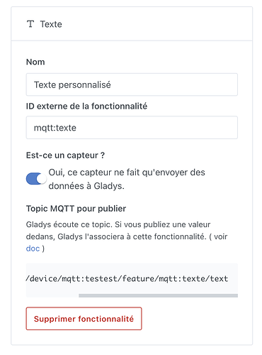

What I propose is, in the MQTT integration, a new feature type « Text »:
This device exposes a new MQTT topic:
gladys/master/device/{device_selector}/feature/{device_feature_selector}/text

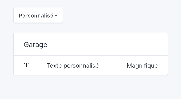

Then, by sending an MQTT message containing the desired text:
The message is simply displayed on the dashboard:
The feature is available in a PR here:
