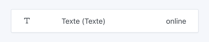

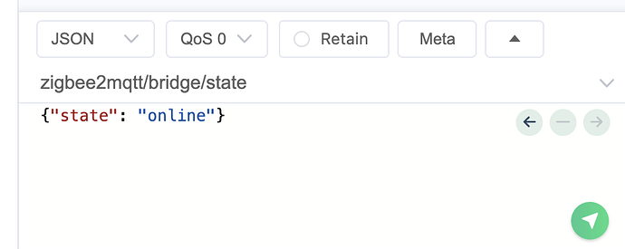

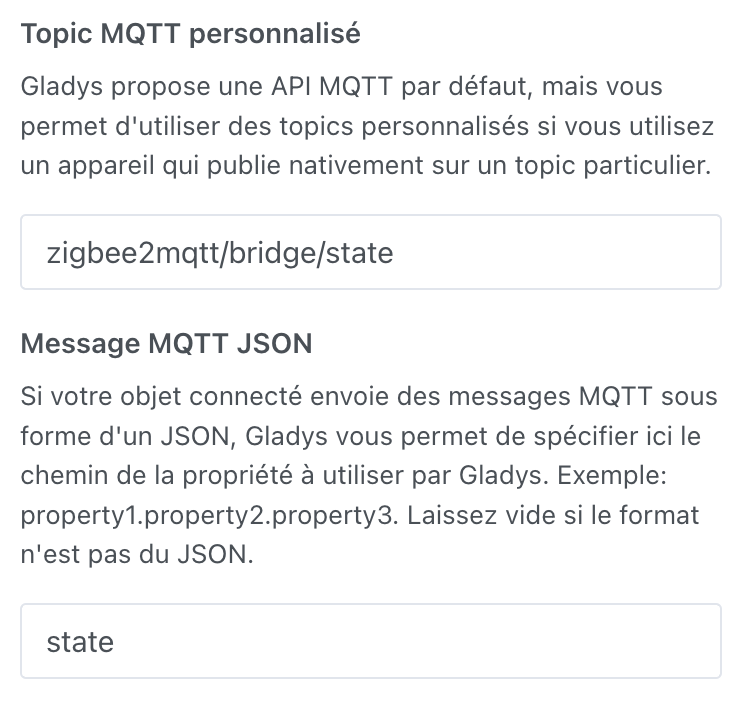

If I configure a feature with a custom MQTT topic :
When I send a message on this custom topic :
I can see this text on my dashboard :
