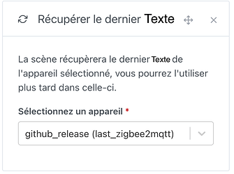

In scenes, you can retrieve the last « state » of an MQTT sensor.
I would like to be able to retrieve the last « text » of an MQTT Text sensor to then reuse it in scenes:
I’m wondering whether it’s useful to create a new action, or whether it’s instead the ‹ retrieve last state › action that should be improved to also work with text sensors…

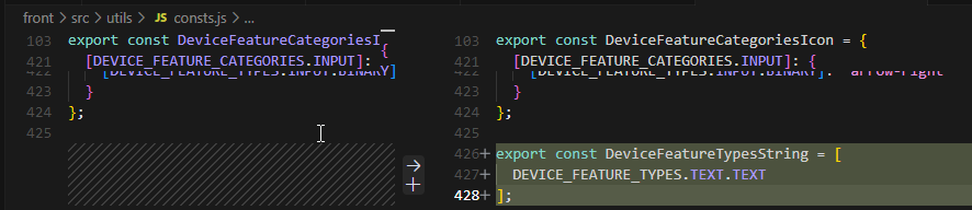

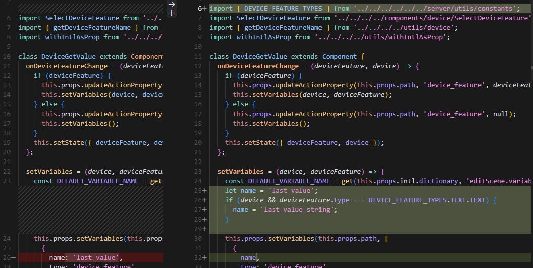

The change :
@pierre-gilles, since I already know there will be other « string » types coming, I took the liberty of creating a constant in the utils to list the string types. Does that work for you?
The PR : Update DeviceGetValueParams to handle text device feature type by Terdious · Pull Request #2317 · GladysAssistant/Gladys · GitHub

That looks perfect to me @Terdious, I’ll test tomorrow and if it’s good I’ll merge, but as far as the code goes it looks good to me!
Looks good to me, tested and merged :slight_smile:
