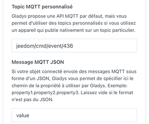

following @pierre-gilles’ PR here, I tried to retrieve a text value, but it won’t work for me :frowning:

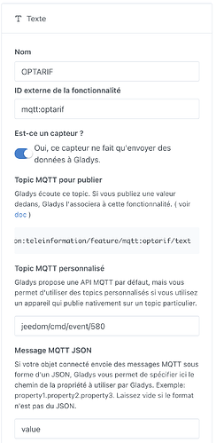

Here are my params:
I think there’s something I’m not doing right but I’m completely stuck.

Here are some info/logs that I retrieved, in case it can help, and help me.

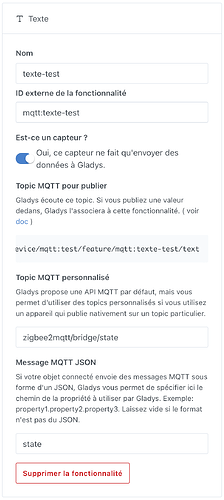

I recreated a custom topic (a Text type feature) on my prod instance:
The topic is being listened to, I can see it in Debug:

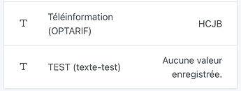

But nothing is displayed on the dashboard:
And here is a snippet of the log where you can see this topic (2025-05-14T21:55:03):

So I really don’t understand anything anymore because I have a custom topic that works… And it’s one that I created several months ago, so well before this 4.58 version arrived!
However, I don’t have the logs because it only changes at 10 PM and 6 AM (HC and HP) and I don’t know how to retrieve them.
@mutmut could you restart Gladys (docker restart gladys), and check the logs when Gladys starts up?
Maybe you have a custom MQTT topic that’s causing an issue and preventing other topics from loading. We’ve had a similar issue in the past!
Don’t worry, we’ll figure it out :slight_smile:
@pierre-gilles I just sent you my startup logs; personally I’m having trouble interpreting them in detail but from what I can see, I have several subscription lines to identical custom topics yet I only have one of them each time.
The only thing that would cause duplicates is tests I ran by creating and deleting features with custom topics.
And that seems to mean that those deleted features still exist but as ghosts (according to my analysis).
Actually, I think I’ve been going in circles on this thread from the beginning of the year (and my early deep dives into Gladys), which is still unresolved: Besoin d'aide sur des messages d'erreur MQTT personnalisé - #10 par pierre-gilles
Thanks for your reply @mutmut :slight_smile:
At first glance, it seems that an issue on one of the devices is preventing the others from listening.
A good first step would be to isolate the listeners from each other to prevent a crash from stopping the others from working. And of course, add more logs to better understand what’s happening on those that are encountering a problem.
If you agree, you can also send me your database privately. That would help me analyze the situation more quickly :slight_smile:
I’m working on Gladys tomorrow — I’ll make a note to take a look at all of this then!
Thank you very much for your DB @mutmut, I saw exactly what was wrong :smiley:
When a feature with a custom topic is deleted, the feature is indeed deleted… but not the custom topic which remains « forever » in Gladys, and that’s what causes the errors you saw.
I’m working on a fix!
Fixed in this PR:
This will be included in the next Gladys release :slight_smile:

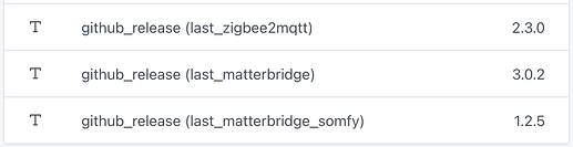

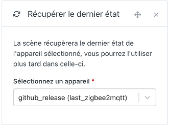

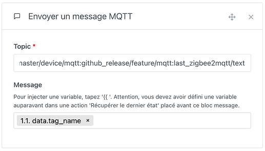

I don’t know if I missed something or not but I can’t retrieve an MQTT Text variable created via Gladys (and not from a custom topic).
Here is my scenario :
Note: if this needs to be moved to a new post, don’t hesitate, mods.
I’d appreciate it if you could create a feature request, because it’s not possible currently with the « Get last state » action which doesn’t handle text features :slight_smile:
