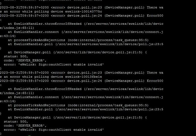

I’m replying in case this can help — here are my logs, you can clearly see Ewelink errors
Thanks @pascal_sapin, could you by any chance look at the logs at the moment you connect to eWeLink? Right now it’s an error that just says that e
I tried to reconnect
then uploaded the logs
there you go

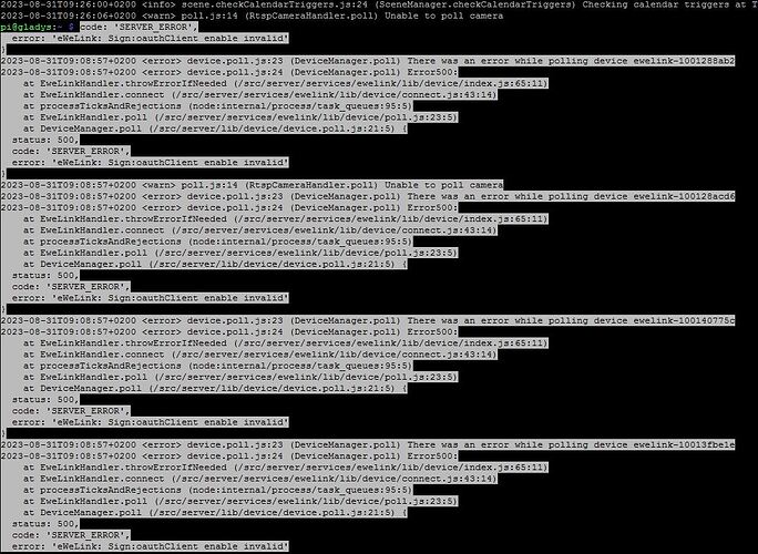

These are the same logs — can you try reconnecting but with live logs?
You can do:
docker logs gladys --tail=100 -f
(the « -f » indicates that you want the logs live, the --tail=100 indicates that you don’t want more than the last 100 logs)
Then, reconnect, and I want to see the logs from the moment you make the connection.

    at EweLinkHandler.connect (/src/server/services/ewelink/lib/device/connect.j                      s:43:14)
    at processTicksAndRejections (node:internal/process/task_queues:95:5)
    at EweLinkHandler.poll (/src/server/services/ewelink/lib/device/poll.js:23:5                      )
    at DeviceManager.poll (/src/server/lib/device/device.poll.js:21:5) {
  status: 500,
  code: 'SERVER_ERROR',
  error: 'eWeLink: Sign:oauthClient enable invalid'
2023-08-31T11:15:00+0200 <info> scene.checkCalendarTriggers.js:24 (SceneManager.                      checkCalendarTriggers) Checking calendar triggers at Thu, 31 Aug 2023 09:15:00 G                      MT
2023-08-31T11:15:06+0200 <warn> poll.js:14 (RtspCameraHandler.poll) Unable to poll camera
2023-08-31T11:15:16+0200 <warn> poll.js:14 (RtspCameraHandler.poll) Unable to poll camera
2023-08-31T11:15:26+0200 <warn> poll.js:14 (RtspCameraHandler.poll) Unable to poll camera
2023-08-31T11:15:27+0200 <error> device.poll.js:23 (DeviceManager.poll) There was an error while polling device ewelink-100078c077
2023-08-31T11:15:27+0200 <error> device.poll.js:24 (DeviceManager.poll) Error500:
    at EweLinkHandler.throwErrorIfNeeded (/src/server/services/ewelink/lib/device/index.js:65:11)
    at EweLinkHandler.connect (/src/server/services/ewelink/lib/device/connect.js:43:14)
    at EweLinkHandler.poll (/src/server/services/ewelink/lib/device/poll.js:23:5)
  status: 500,
2023-08-31T11:15:27+0200 <error> device.poll.js:23 (DeviceManager.poll) There was an error while polling device ewelink-1001288ab2
  status: 500,
2023-08-31T11:15:27+0200 <error> device.poll.js:23 (DeviceManager.poll) There was an error while polling device ewelink-100128acd6
  status: 500,
2023-08-31T11:15:27+0200 <error> device.poll.js:23 (DeviceManager.poll) There was an error while polling device ewelink-100140775c
  status: 500,
2023-08-31T11:15:28+0200 <error> device.poll.js:23 (DeviceManager.poll) There was an error while polling device ewelink-10013fbe1e
2023-08-31T11:15:28+0200 <error> device.poll.js:24 (DeviceManager.poll) Error500:
  status: 500,
2023-08-31T11:15:36+0200 <warn> poll.js:14 (RtspCameraHandler.poll) Unable to poll camera
2023-08-31T11:15:46+0200 <warn> poll.js:14 (RtspCameraHandler.poll) Unable to poll camera
2023-08-31T11:15:56+0200 <warn> poll.js:14 (RtspCameraHandler.poll) Unable to poll camera
2023-08-31T11:15:57+0200 <error> device.poll.js:23 (DeviceManager.poll) There was an error while polling device ewelink-100078c077
2023-08-31T11:15:57+0200 <error> device.poll.js:24 (DeviceManager.poll) Error500:
  status: 500,
2023-08-31T11:15:57+0200 <error> device.poll.js:23 (DeviceManager.poll) There was an error while polling device ewelink-1001288ab2
  status: 500,
2023-08-31T11:15:57+0200 <error> device.poll.js:23 (DeviceManager.poll) There was an error while polling device ewelink-100128acd6
  status: 500,
2023-08-31T11:15:57+0200 <error> device.poll.js:23 (DeviceManager.poll) There was an error while polling device ewelink-100140775c
  status: 500,
2023-08-31T11:15:58+0200 <error> device.poll.js:23 (DeviceManager.poll) There was an error while polling device ewelink-10013fbe1e
2023-08-31T11:15:58+0200 <error> device.poll.js:24 (DeviceManager.poll) Error500:
  status: 500,
2023-08-31T11:16:00+0200 <info> scene.checkCalendarTriggers.js:24 (SceneManager.checkCalendarTriggers) Checking calendar triggers at Thu, 31 Aug 2023 09:16:00 GMT

Here’s what I’m seeing this morning :face_with_raised_eyebrow:
2023-09-01T08:33:40+0200 \u003cerror\u003e device.poll.js:23 (DeviceManager.poll) There was an error while polling device ewelink-10013a843f
2023-09-01T08:33:40+0200 \u003cerror\u003e device.poll.js:24 (DeviceManager.poll) Error500:
  status: 500,
2023-09-01T08:33:40+0200 \u003cerror\u003e device.poll.js:23 (DeviceManager.poll) There was an error while polling device ewelink-100183db8a
  status: 500,
2023-09-01T08:33:40+0200 \u003cerror\u003e device.poll.js:23 (DeviceManager.poll) There was an error while polling device ewelink-100183d0f0
  status: 500,
2023-09-01T08:33:41+0200 \u003cerror\u003e device.poll.js:23 (DeviceManager.poll) There was an error while polling device ewelink-1000b0b43e
2023-09-01T08:33:41+0200 \u003cerror\u003e device.poll.js:24 (DeviceManager.poll) Error500:
  status: 500,
2023-09-01T08:33:41+0200 \u003cerror\u003e device.poll.js:23 (DeviceManager.poll) There was an error while polling device ewelink-1000cf4d84
  status: 500,
2023-09-01T08:33:41+0200 \u003cerror\u003e device.poll.js:23 (DeviceManager.poll) There was an error while polling device ewelink-1000cc65bd
  status: 500,
2023-09-01T08:33:41+0200 \u003cerror\u003e device.poll.js:23 (DeviceManager.poll) There was an error while polling device ewelink-1000475e64
  status: 500,
2023-09-01T08:33:41+0200 \u003cerror\u003e device.poll.js:23 (DeviceManager.poll) There was an error while polling device ewelink-10013a8d6a
  status: 500,
Unfortunately they’re the same logs, that doesn’t help me any more :stuck_out_tongue:
Can one of you give me your credentials temporarily so I can test?
Done via PM

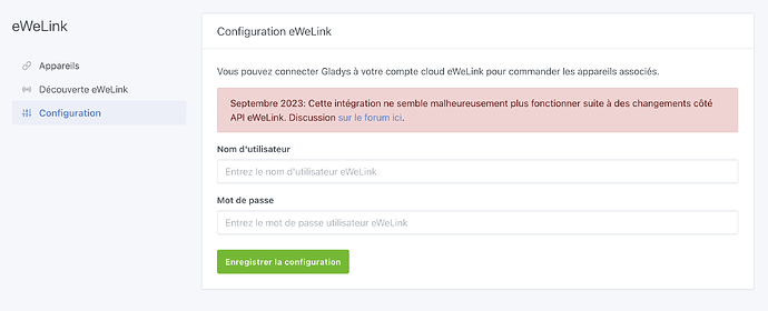

The issue is known on the library side: Error: 406 { error: 406, msg: 'Authentication failed' } · Issue #221 · skydiver/ewelink-api · GitHub. With the new API, things have changed. We’ll see whether a new version will arrive — in the thread they mentioned https://www.npmjs.com/package/ewelink-api-next, which appears to be more recent.
Thanks @tiboys I just saw, but indeed @ProtZ is right, the library is no longer functional, the conclusion on the topic you quote is:
So in summary - its time to give up trying to make this project work (as it uses the old v1 endpoints and an outdated method of connection with a password stored in plain text in your code) and move to the meow common and more secure OAuth2.0 authorisation flow with the resultant token to use as a bearer token in future requests.
Even the lib « ewelin-api-next » apparently isn’t functional:
There is « start » of such a project at « ewelink-api-next » but it’s completely missing the OAuth stuff according to the TODO list and even I was unable to make it actually control my devices.
Unfortunately there is therefore no bug on Gladys’s side to fix, what I see is:
  • First, deprecate the current integration with a message to warn users to avoid frustrations like this.
  • See if an integration is feasible with the new API; there’s not necessarily a need to wait for a new Node lib, it could be an integration we build ourselves with the Ewelink REST API. I don’t know if you want to take that on @ProtZ? :slight_smile:
I’m adding a message to avoid frustrations :
The PR :
Thanks for the answers — so if I understand correctly, it’s no longer possible to use my Sonoff devices for now, unless I have to flash everything to Tasmota, for example?
Indeed!
