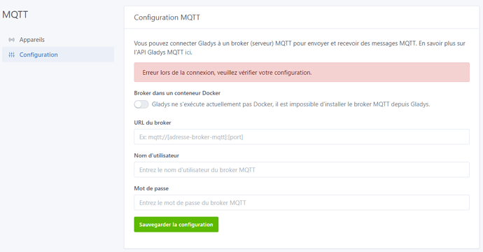

Configuration MQTT: Connection error, please check your configuration. After restoring Gladys to the Bullseye image
After installing the Bullseye image of Gladys on my Pi, I wanted to restore it with Gladys Plus; in the MQTT configuration, there is « Error during connection, please check your configuration. » and the button to enable the broker is grayed out.
image_2021-12-06_175437
On the old image, MQTT was working fine…
I assume that Mosquitto was not recreated during the restore…
What can I do?

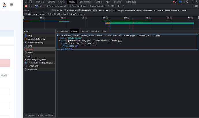

@Xenicle To help us see what’s wrong, could you open your browser console on the MQTT integration page (Right-click on the web page → Inspect element → Network)
Then look for the request GET IP_DU_PI/api/v1/service/mqtt/config, and take a screenshot of the « Preview » tab like this:
(You can optionally hide the password in the screenshot if the password field displays something)
Here is the result of the query:

2021-12-06T17:36:10+0100 <info> service.startAll.js:30 () Service zwave was manually stopped, so it is ignored at startup
2021-12-06T17:36:10+0100 <info> service.startAll.js:30 () Service tasmota was manually stopped, so it is ignored at startup
2021-12-06T17:36:10+0100 <info> service.startAll.js:30 () Service ewelink was manually stopped, so it is ignored at startup
2021-12-06T17:36:10+0100 <info> service.startAll.js:30 () Service tp-link was manually stopped, so it is ignored at startup
2021-12-06T17:36:10+0100 <info> service.startAll.js:30 () Service zigbee2mqtt was manually stopped, so it is ignored at startup
2021-12-06T17:36:10+0100 <info> index.js:19 (Object.start) Starting Telegram service
2021-12-06T17:36:10+0100 <info> service.start.js:40 (Service.start) Service telegram is not configured, so it was not started.
2021-12-06T17:36:10+0100 <info> index.js:64 (Object.start) Starting CalDAV service
2021-12-06T17:36:10+0100 <info> index.js:20 (Object.start) Starting Open Weather service
2021-12-06T17:36:10+0100 <info> index.js:16 (Object.start) Starting MQTT service
2021-12-06T17:36:11+0100 <warn> service.start.js:44 (Service.start) Unable to start service mqtt Error: (HTTP code 301) unexpected -
    at /src/server/node_modules/docker-modem/lib/modem.js:301:17
    at getCause (/src/server/node_modules/docker-modem/lib/modem.js:331:7)
    at Modem.buildPayload (/src/server/node_modules/docker-modem/lib/modem.js:300:5)
    at IncomingMessage.<anonymous> (/src/server/node_modules/docker-modem/lib/modem.js:275:14)
    at IncomingMessage.emit (events.js:412:35)
    at endReadableNT (internal/streams/readable.js:1334:12)
    at processTicksAndRejections (internal/process/task_queues.js:82:21) {
  reason: undefined,
  statusCode: 301,
  json: <Buffer >
2021-12-06T17:36:11+0100 <error> index.js:20 (process.<anonymous>) uncaughtException catched: uncaughtException
2021-12-06T17:36:11+0100 <error> index.js:21 (process.<anonymous>) Error: getaddrinfo ENOTFOUND containers
    at GetAddrInfoReqWrap.onlookup [as oncomplete] (dns.js:71:26) {
  errno: -3008,
  code: 'ENOTFOUND',
  syscall: 'getaddrinfo',
  hostname: 'containers'
2021-12-06T17:36:11+0100 <info> index.js:14 (Object.start) starting GoogleActions service
2021-12-06T17:36:11+0100 <info> index.js:15 (Object.start) Starting Bluetooth service
2021-12-06T17:36:12+0100 <info> bluetooth.initPresenceScanner.js:18 (BluetoothManager.initPresenceScanner) Bluetooth configuration: starting presence scanner
2021-12-06T17:36:12+0100 <info> bluetooth.initPresenceScanner.js:13 (BluetoothManager.initPresenceScanner) Bluetooth configuration: stopping presence scanner
2021-12-06T17:36:12+0100 <info> index.js:14 (Object.start) Starting Xiaomi service
2021-12-06T17:36:12+0100 <info> index.js:13 (Object.start) Starting usb service
2021-12-06T17:36:12+0100 <info> scene.dailyUpdate.js:58 () Sunrise today is at 8:13 today, in your timezone = Europe/Paris
2021-12-06T17:36:12+0100 <info> scene.dailyUpdate.js:59 () Sunset today is at 16:41 today, in your timezone = Europe/Paris
2021-12-06T17:36:12+0100 <info> scene.dailyUpdate.js:70 () The sun rose this morning. Not scheduling for today.
2021-12-06T17:36:12+0100 <info> scene.dailyUpdate.js:84 () The sun has already set. Not scheduling for today.
2021-12-06T17:36:12+0100 <info> device.calculateAggregate.js:38 (DeviceManager.calculateAggregate) Calculating aggregates device feature state for interval hourly
2021-12-06T17:36:12+0100 <info> index.js:63 (Server.<anonymous>) Server listening on port 80
2021-12-06T17:36:14+0100 <info> index.js:801 (Socket.<anonymous>) Gladys Gateway: connected in websockets
2021-12-06T17:36:14+0100 <info> gateway.checkIfBackupNeeded.js:27 (Gateway.checkIfBackupNeeded) Not backing up instance to Gladys Gateway, last backup is recent.
2021-12-06T17:36:22+0100 <info> device.calculateAggregate.js:105 (ChildProcess.<anonymous>) device.calculateAggregate: Finishing processing for interval hourly
2021-12-06T17:36:22+0100 <info> device.calculateAggregate.js:38 (DeviceManager.calculateAggregate) Calculating aggregates device feature state for interval daily
2021-12-06T17:36:36+0100 <warn> scene.executeActions.js:37 (executeAction) ServiceNotConfiguredError
    at MqttHandler.setValue (/src/server/services/mqtt/lib/setValue.js:19:11)
    at DeviceManager.setValue (/src/server/lib/device/device.setValue.js:21:24)
    at Object.device.set-value (/src/server/lib/scene/scene.actions.js:30:24)
    at executeAction (/src/server/lib/scene/scene.executeActions.js:32:35)
    at SceneManager.executeSingleAction (/src/server/lib/scene/scene.executeSingleAction.js:17:11)
    at EventEmitter.<anonymous> (/src/server/utils/functionsWrapper.js:13:13)
    at EventEmitter.emit (events.js:400:28)
    at Event.emit (/src/server/lib/event/index.js:8:16)
    at setValueFeature (/src/server/api/controllers/device.controller.js:90:18)
    at /src/server/api/middlewares/asyncMiddleware.js:4:19
    at Layer.handle [as handle_request] (/src/server/node_modules/express/lib/router/layer.js:95:5)
    at next (/src/server/node_modules/express/lib/router/route.js:137:13)
    at /src/server/api/middlewares/authMiddleware.js:28:7 {
  message: undefined
2021-12-06T17:36:40+0100 <warn> scene.executeActions.js:37 (executeAction) ServiceNotConfiguredError
  message: undefined
2021-12-06T17:36:48+0100 <info> device.calculateAggregate.js:105 (ChildProcess.<anonymous>) device.calculateAggregate: Finishing processing for interval daily
2021-12-06T17:36:48+0100 <info> device.calculateAggregate.js:38 (DeviceManager.calculateAggregate) Calculating aggregates device feature state for interval monthly
2021-12-06T17:36:50+0100 <error> index.js:20 (process.<anonymous>) uncaughtException catched: uncaughtException
2021-12-06T17:36:50+0100 <error> index.js:21 (process.<anonymous>) Error: getaddrinfo ENOTFOUND containers
  errno: -3008,
  code: 'ENOTFOUND',
2021-12-06T17:36:53+0100 <info> device.calculateAggregate.js:105 (ChildProcess.<anonymous>) device.calculateAggregate: Finishing processing for interval monthly
2021-12-06T17:37:33+0100 <error> index.js:20 (process.<anonymous>) uncaughtException catched: uncaughtException
2021-12-06T17:37:33+0100 <error> index.js:21 (process.<anonymous>) Error: getaddrinfo ENOTFOUND containers
  errno: -3008,
  code: 'ENOTFOUND',
2021-12-06T17:40:55+0100 <error> index.js:20 (process.<anonymous>) uncaughtException catched: uncaughtException
2021-12-06T17:40:55+0100 <error> index.js:21 (process.<anonymous>) Error: getaddrinfo ENOTFOUND containers
  errno: -3008,
  code: 'ENOTFOUND',
2021-12-06T17:49:04+0100 <error> index.js:20 (process.<anonymous>) uncaughtException catched: uncaughtException
2021-12-06T17:49:04+0100 <error> index.js:21 (process.<anonymous>) Error: getaddrinfo ENOTFOUND containers
  errno: -3008,
  code: 'ENOTFOUND',
2021-12-06T17:49:13+0100 <info> index.js:16 (Object.start) Starting MQTT service
2021-12-06T17:49:14+0100 <warn> service.start.js:44 (Service.start) Unable to start service mqtt Error: (HTTP code 301) unexpected -
  reason: undefined,
  statusCode: 301,
  json: <Buffer >
2021-12-06T17:49:14+0100 <error> index.js:20 (process.<anonymous>) uncaughtException catched: uncaughtException
2021-12-06T17:49:14+0100 <error> index.js:21 (process.<anonymous>) Error: getaddrinfo ENOTFOUND containers
  errno: -3008,
  code: 'ENOTFOUND',
2021-12-06T17:49:14+0100 <info> index.js:16 (Object.start) Starting MQTT service
  reason: undefined,
  statusCode: 301,
  json: <Buffer >
  errno: -3008,
  code: 'ENOTFOUND',
2021-12-06T17:49:19+0100 <error> index.js:20 (process.<anonymous>) uncaughtException catched: uncaughtException
2021-12-06T17:49:19+0100 <error> index.js:21 (process.<anonymous>) Error: getaddrinfo ENOTFOUND containers
  errno: -3008,
  code: 'ENOTFOUND',
2021-12-06T17:53:00+0100 <info> index.js:16 (Object.start) Starting MQTT service
2021-12-06T17:53:00+0100 <warn> service.start.js:44 (Service.start) Unable to start service mqtt Error: (HTTP code 301) unexpected -
  reason: undefined,
  statusCode: 301,
  json: <Buffer >
2021-12-06T17:53:00+0100 <error> index.js:20 (process.<anonymous>) uncaughtException catched: uncaughtException
2021-12-06T17:53:00+0100 <error> index.js:21 (process.<anonymous>) Error: getaddrinfo ENOTFOUND containers
  errno: -3008,
  code: 'ENOTFOUND',
2021-12-06T17:53:01+0100 <info> index.js:16 (Object.start) Starting MQTT service
2021-12-06T17:53:01+0100 <warn> service.start.js:44 (Service.start) Unable to start service mqtt Error: (HTTP code 301) unexpected -
  reason: undefined,
  statusCode: 301,
  json: <Buffer >
2021-12-06T17:53:01+0100 <error> index.js:20 (process.<anonymous>) uncaughtException catched: uncaughtException
2021-12-06T17:53:01+0100 <error> index.js:21 (process.<anonymous>) Error: getaddrinfo ENOTFOUND containers
  errno: -3008,
  code: 'ENOTFOUND',
  reason: undefined,
  statusCode: 301,
  json: <Buffer >
  errno: -3008,
  code: 'ENOTFOUND',

Thank you very much!
The error seems to be as follows:
@VonOx Not sure if this is related to the new image, but apparently Docker calls from inside the container do not seem to be working in this case. The docker run command hasn’t changed though?
Perhaps the Docker version is no longer the same on this new build?
Yes, it’s certain that the version is more recent but the problem is not there (well, I don’t think so)
We should first see what we have in terms of containers. (a priori it does not exist)
One hypothesis could be the pull limit on Docker Hub. (as a result, we have a bastard state on Gladys’ side)
What does docker ps -a return?
And docker images?
Another hypothesis, incompatibility between dockerode and docker versions
CONTAINER ID   IMAGE                       COMMAND                  CREATED       STATUS                 PORTS      NAMES
613f886a1c38   nodered/node-red            "npm --no-update-not…"   4 hours ago   Up 4 hours (healthy)              node_red
8581b2f237a8   gladysassistant/gladys:v4   "docker-entrypoint.s…"   4 hours ago   Up 3 hours                        gladys
809ee9cca6b0   containrrr/watchtower       "/watchtower --clean…"   4 hours ago   Up 4 hours             8080/tcp   watchtower
REPOSITORY                                 TAG       IMAGE ID       CREATED        SIZE
nodered/node-red                           latest    d2d65a14931d   35 hours ago   444MB
gladysassistant/gladys                     v4        0b6844316e0e   10 days ago    476MB
containrrr/watchtower                      latest    9167b324e914   7 months ago   13.9MB
gladysassistant/gladys-setup-in-progress   latest    cc0d3cac5829   8 months ago   16.4MB
Thanks, so there wasn’t even a pull of the image
You can try manually to see if the Docker CLI returns an error?
docker pull eclipse-mosquitto:2
Yes, except that now it’s the « docker ps » that fails from inside the container, so in my opinion there is a communication problem between the inside of the container and docker (or indeed an incompatibility between dockerode and the version of docker we are using)
pi@raspberrypi:~ $ docker pull eclipse-mosquitto:2
2: Pulling from library/eclipse-mosquitto
56afcfda5d78: Pull complete
7cc5dfa21678: Pull complete
193ff21ebef8: Pull complete
Digest: sha256:64b7c1729f7d1fff46b5e884fc389071686b2f7ed116c3fc7e17cbcb50fa147e
Status: Downloaded newer image for eclipse-mosquitto:2
docker.io/library/eclipse-mosquitto:2
pi@raspberrypi:~ $ docker ps -a
613f886a1c38   nodered/node-red            "npm --no-update-not…"   5 hours ago   Up 5 hours (healthy)              node_red
8581b2f237a8   gladysassistant/gladys:v4   "docker-entrypoint.s…"   6 hours ago   Up 5 hours                        gladys
809ee9cca6b0   containrrr/watchtower       "/watchtower --clean…"   6 hours ago   Up 5 hours             8080/tcp   watchtower
pi@raspberrypi:~ $ docker images
nodered/node-red                           latest    d2d65a14931d   37 hours ago   444MB
eclipse-mosquitto                          2         b24dbb9c5469   2 weeks ago    9.93MB

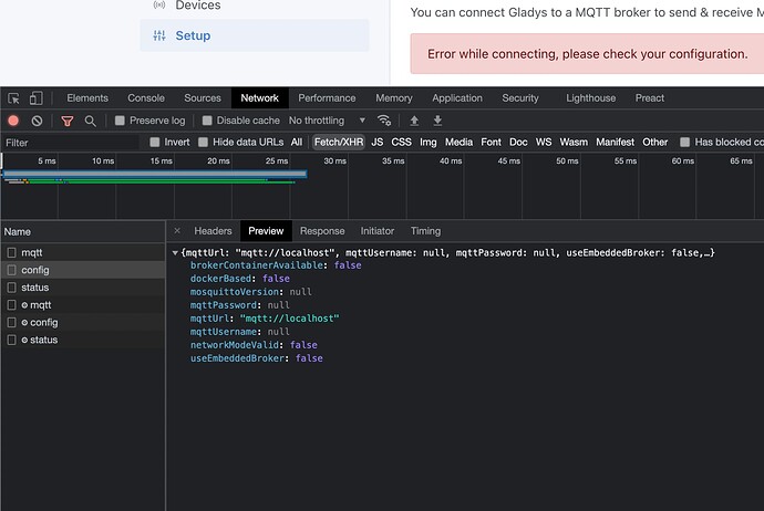

I hadn’t seen the screenshots on mobile well, but the is Docker is false.
This means that the .dockerenv no longer exists.
Is it possible to recreate it?
You can first test docker exec -it gladys ls /.dockerenv
If the file does not exist you can create it (temporary solution as the change will be overwritten during the next update)
docker exec -it gladys touch /.dockerenv
After restarting the container, the mqtt installation should work fine
docker restart gladys
