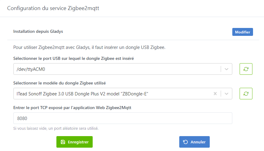

I wanted to integrate my Zigbee devices into Gladys. To be complete, I have a test setup using Zigbee2MQTT controlled via Node-RED installed on the Freebox. In Gladys, I wanted to start from scratch by choosing the « Install from Gladys » option. I plugged the Sonoff dongle I had previously used into the box, on the new Gladys installation (a Beelink like in your training). I was able to connect only once; since then it’s been impossible to get a proper connection.
Here is a screenshot:

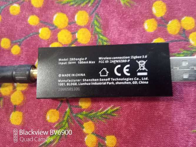

Are you sure your dongle is a Sonoff model P? The Sonoff units sold on Domadoo are model E at the moment (it’s written on the back of the dongle and on the box)
Many thanks Pierre-Gilles, I think I’m not even good at using the forum :joy:
I use a Dongle bought a few years ago (see photo) that works well on my old setup.
To start from a correct installation, I have just ordered a new Dongle. I should receive it in a few days and I’ll get back to you.
Buying a second Dongle allows me to separate the two installations (old and new) and to carry out all possible tests safely (without ending up without light) before switching to Gladys.

Step 1: Installation choice from Gladys
Step 2: Configuration of the ZigBee2MQTT service
Step 3: After waiting for several dozen minutes, I still get the following messages:
