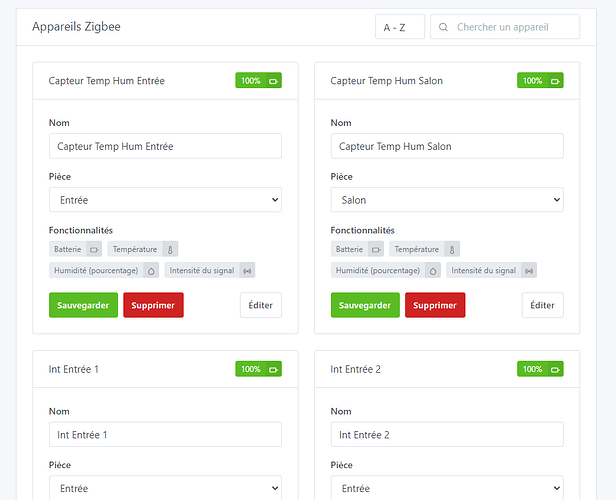

In Zigbee2mqtt the devices are present :
as well as in Gladys :

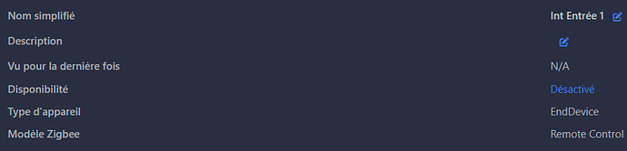

However, on the « last seen » line in Zigbee2mqtt :
I’ve tried restarting the mini PC and also the Zigbee2mqtt container and nothing has changed…
What else can I do? :slight_smile:

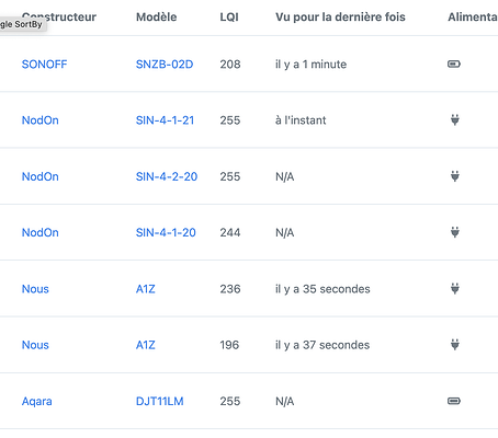

So this won’t help move your problem forward (sorry) but I’ve never had a date in « Last seen », only N/A for all my devices … and I figured it was normal (even if not great for doing checks).
For Zigbee users, do you have anything other than N/A?
I also have N/A on my end :wink:

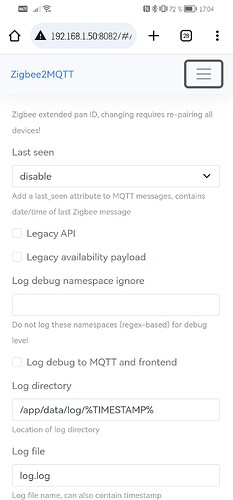

You need to enable it in Z2M’s advanced settings
well, that one had to be found :stuck_out_tongue_winking_eye:
and now:
Quick question: do we retrieve the last_seen in Gladys?
In any case, a big thank you @GBoulvin!

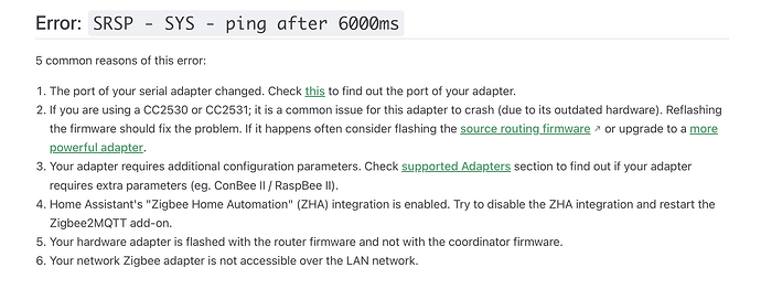

Did you see this Zigbee2MQTT documentation about the bug?
(Source: https://www.zigbee2mqtt.io/guide/installation/20_zigbee2mqtt-fails-to-start.html#error-srsp-sys-ping-after-6000ms)
In the community, we also had users who experienced power issues with the dongle, often present on Raspberry Pis (not on mini-PCs, apparently)

Thanks for your reply :wink: yes I know this doc, I know that at this level I’m all good!
